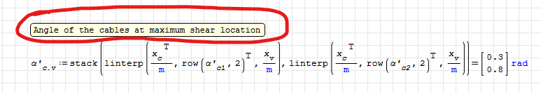

You lost me there. Are you saying it is possible to change the colour of description background (see below) from the default yellow?

Thanks Jean. I think we misunderstood each other. I was proposing to change the background of the description region/field, rather than the input region, as your example shows. Something like this:

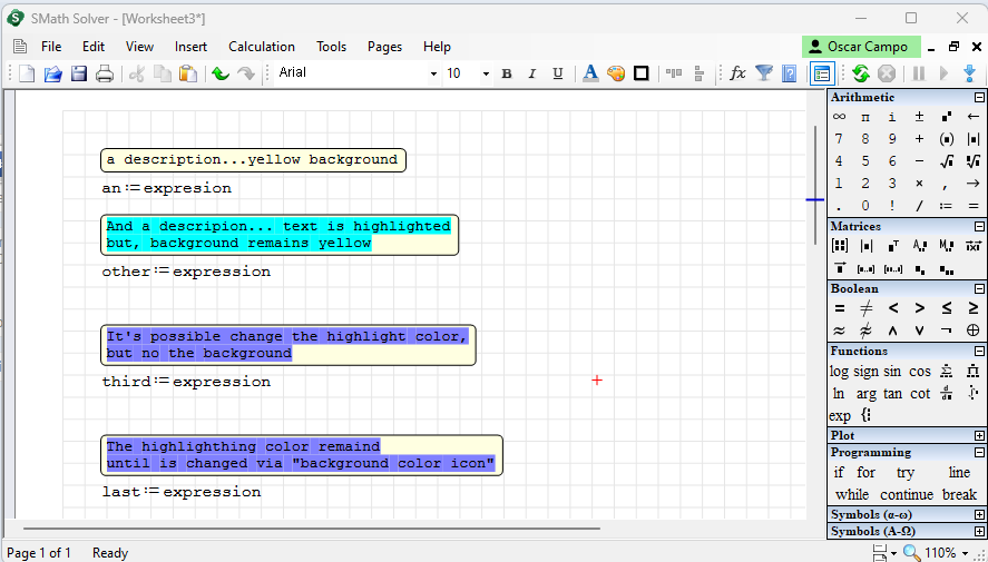

It's not possible change the background color of description region.
Only it's possible change the color which the text is highlighted inside a description region.
Please see this video:
This is not persistent. Possibly just a visual bug.
Background color changes to description text is not saved.
I checked with an external text editor, no data saved related to it.
They are same with yellow background and colorful highlighted.
When you save file, close it and reopen it all colors will revert.
Either to latest selected background or yellow.

But, before I posted, I did that check you mention. I saved the file, then closed SMath, reopened, and the colors remain...

Close smath, reopen with a blank page, change background color to white, close file without saving.
Now reopen smath with the file you saved, background highlight should be gone.
Oscar Campo 20.09.2023 11:37:00

Yep..
you're right...
it's only a bug
Thanks!!
