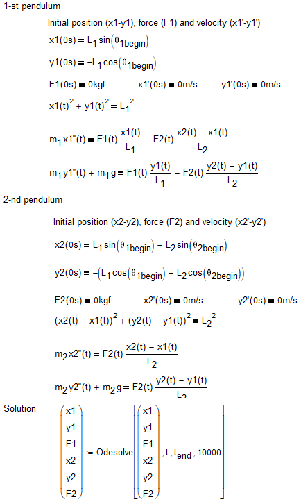

I feel the model is not correct - help please!
Pendulum-2-animation.sm (22,59 КиБ) скачан 165 раз(а).
Отредактировано 20.09.2026 10:09:28

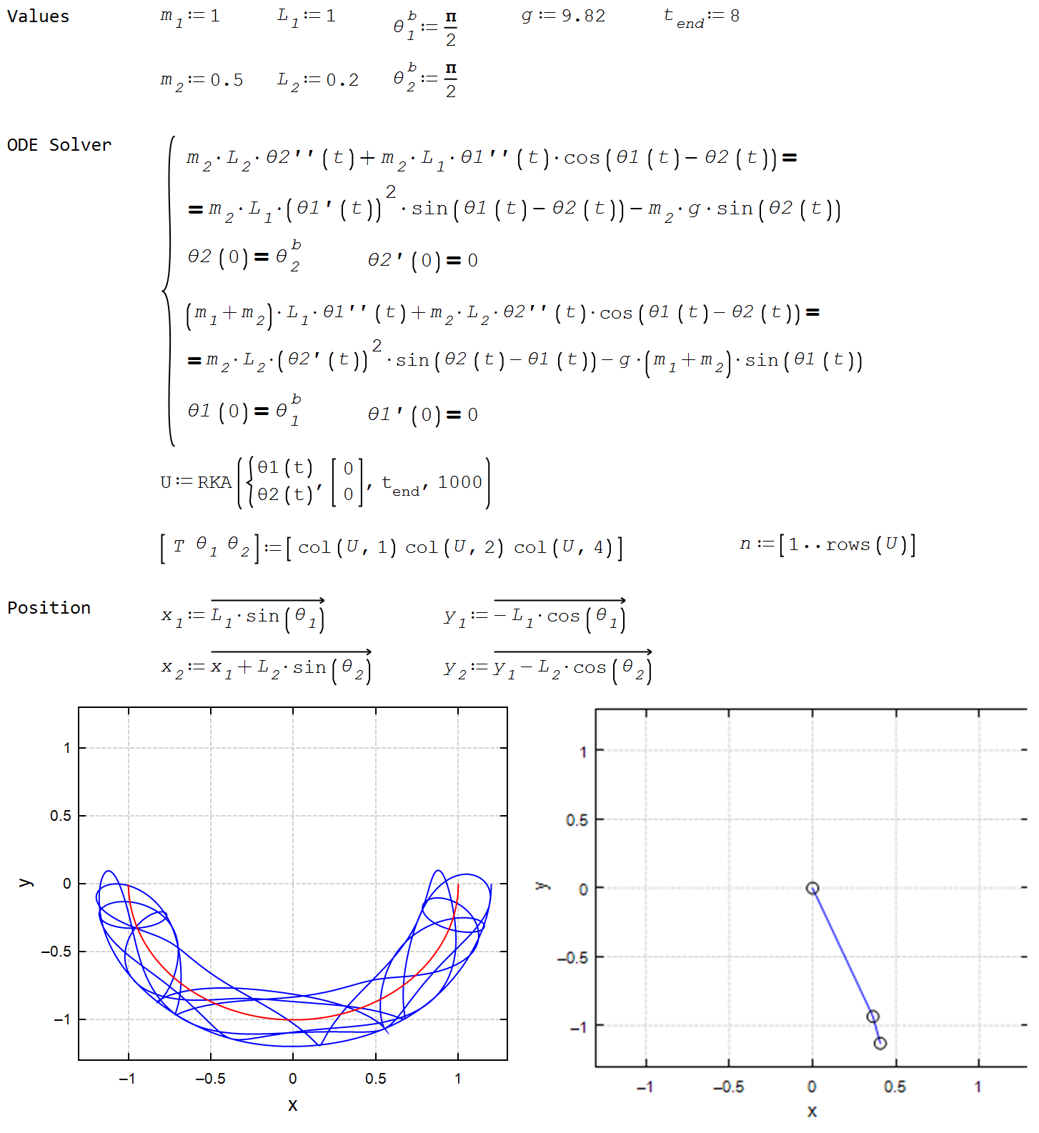

Hi Valery. The system is coupled. This is a way to solve it.
double_pendulum_lagrangian.sm (122,44 КиБ) скачан 163 раз(а).
double_pendulum_lagrangian.pdf (637,78 КиБ) скачан 115 раз(а).

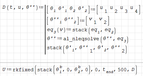

The RKA function includes the necessary procedures to solve hard coupled systems.
double_pendulum_RKA.pdf (483,53 КиБ) скачан 105 раз(а).
double_pendulum_RKA.sm (43,57 КиБ) скачан 157 раз(а).
