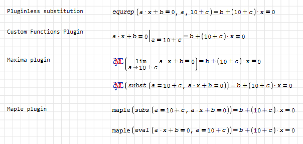

How to make this in Smath:
Mathcad Prime approach:
How is it done this in Smath?
#2 Опубликовано: 04.10.2024 19:38:18
maple-subs.sm (2,94 КиБ) скачан 1525 раз(а).
Links:
1. Maple Tools
2. substitute subexpressions into an expression (maplesoft support)

As curiosity, do you know if maxima engine/plugin has such type of commands: simplify, substitute? Or this things are possible only through maple engine (which this engine maple has these commands)?
#4 Опубликовано: 05.10.2024 00:34:45
subs.sm (9,76 КиБ) скачан 1537 раз(а).
