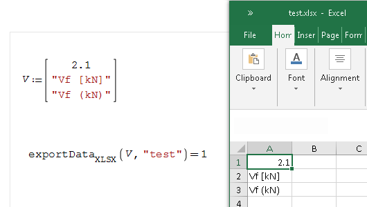

#4 Опубликовано: 11.01.2022 07:39:50
Thank you. I cannot reproduce with latest version.
Please check if there is a new version of XlsxImportExport for your SMath Studio version.
Tools > Plugins > Online Gallery (option in Local Storage button)
Available updates for installed plugins have blue backgrounds.

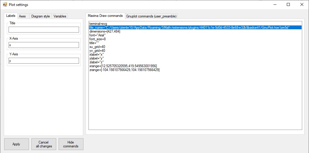

#7 Опубликовано: 11.01.2022 10:20:50
SteelCat
SteelCat
3 сообщений из 47 понравились пользователям.
Цитата
We have several plot regions, which one are you using?
I'm not sure, it's a spreadsheet made by a friend of mine. It's the one that allows Maxima Draw commands and Gnuplot commands in the settings, if could help...
Physics is like sex. Sure, it may give some practical results, but that’s not why we do it. (R. Feynman)
#8 Опубликовано: 11.01.2022 13:45:11
It is the plot from Maxima Plugin. I'll see if I can fix it in the next days.
