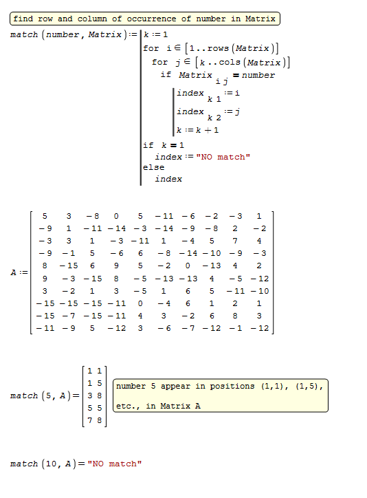

Hello, I'm searching for some function like match(z, A)(Looks in a vector or matrix, A, for a given value, z, and returns the index (indices) of its positions in A) in Mathcad.
I will appreciate any kind of help.
#2 Опубликовано: 22.11.2011 17:34:55
Hello and welcome ,
There is no such function in the function list. Therefore, we could make a user defined one. I hope this will get the job done.
[LIVE width=443 height=419]http://smath.info/live/?file=3273[/LIVE]

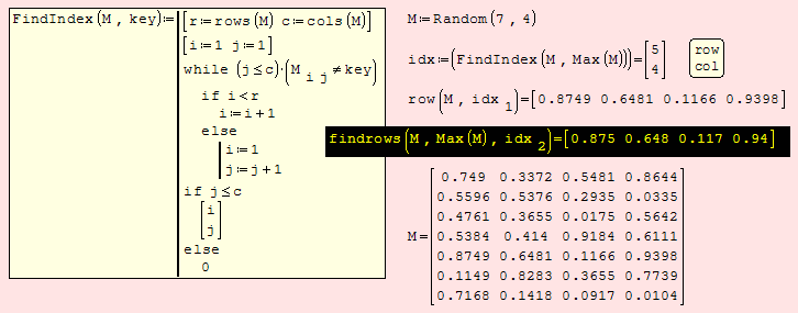

findrows from Smath menu f(x) may just be what you need.
Truncate the matrix/vector to avoid residuals smaller than 10^-15
For more complicated investigation, visit Samples Find Index
posted few days ago ... lot more involved.
Cheers ... Jean.
#6 Опубликовано: 14.10.2022 09:12:57
findrows has limited use unless for specific end use wrt Bolean '0'
For long square/rectangular matrix, better use the assisted code.
match.sm (11,95 КиБ) скачан 1565 раз(а).
Alvaro 26.10.2022 14:46:00
#8 Опубликовано: 26.10.2022 16:26:45
Oscar Campo
Oscar Campo
Some good improvements suggested by Razonar: versions of match() function
