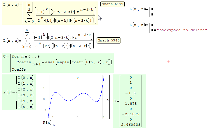

there are known issues with the iterator name of functions like sum, if that variable was previously defined; just clear it before using inside sum.

That what it means. Since 6179, Sum needs be locally defined.

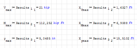

1. I seem to get a bad result (it is incorrect) as noticed by the units. I'm not sure what's going on there.

Not really sure what's going on there while the units are correct, but they shows that something is messed up. What is going different is that nested systems are no more joined (at least for the el() function).
You can use a couple of nested el(), that however are correct for how the result is built (a system of systems)

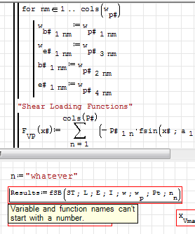

2. Where is 'n' being defined in the original function?
In the for loops before the sums. Try it on the canvas, the iterator variable is available with his last value outside the loop (by design).
Or do I need to clear(n) before every sum?
before any sum in which you might not have the control on what is defined before; In this case, the first sum() inside the function, whatever you use or not use n locally, because n might be used on the canvas. If you still want to use n in amid of 2 sums, you have to clear it again before the second sum. However if you forget it the error status shows that something is gone wrong.

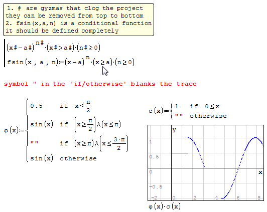

Please, check the attached:
1. Not a case of clearing anything
2. Changed the nSum for mSum
3. Removed all gyzmas #
4. NO error message
I understand nothing in that kind of work,
but results make sense even with units.
Simple Beam - Copy.sm (63,58 КиБ) скачан 1064 раз(а).
