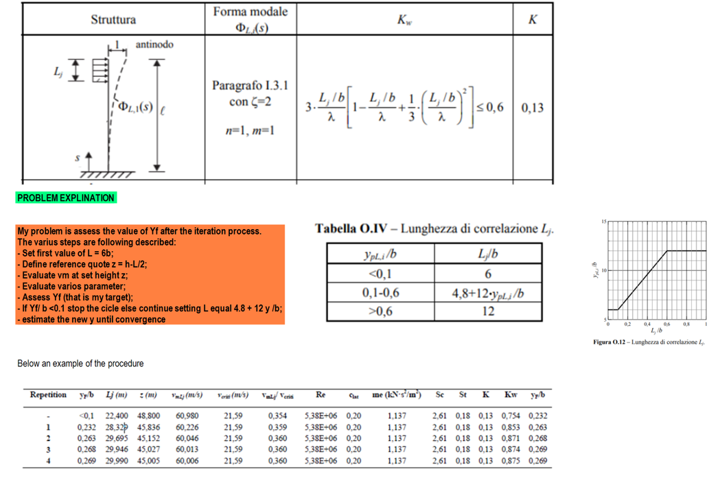

Hi to everybody.
I've got a problem with an interactive assessment of a parameter.
I'm not able to set in the correct manner a "for Cicle".
The general problem is this one
I need to set an initial lenght L0=6b, than
-if the ratio between y/b<0.1 the cicle end and i obtain the value that i need (y and L);
- if the ratio between y/b>0.1 and <0.6 i need to continue the cicle until convergence
Файл не найден.Файл не найден.Файл не найден.
I'm not able to set the correct fuunction
Someone can help setting for me the formulation?
I attach the file below, need to be open with the related excell
Thancks in advance for any answere!

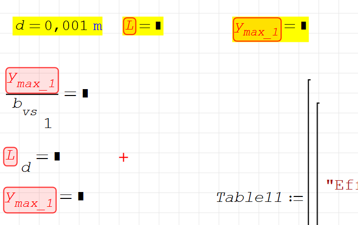

Simple pragmatic suggestion: when I have such errors, firstly I display the values of each term to see if they are already defined:
d is not an index; L is not defined, etc !

Hi to everybody.

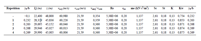

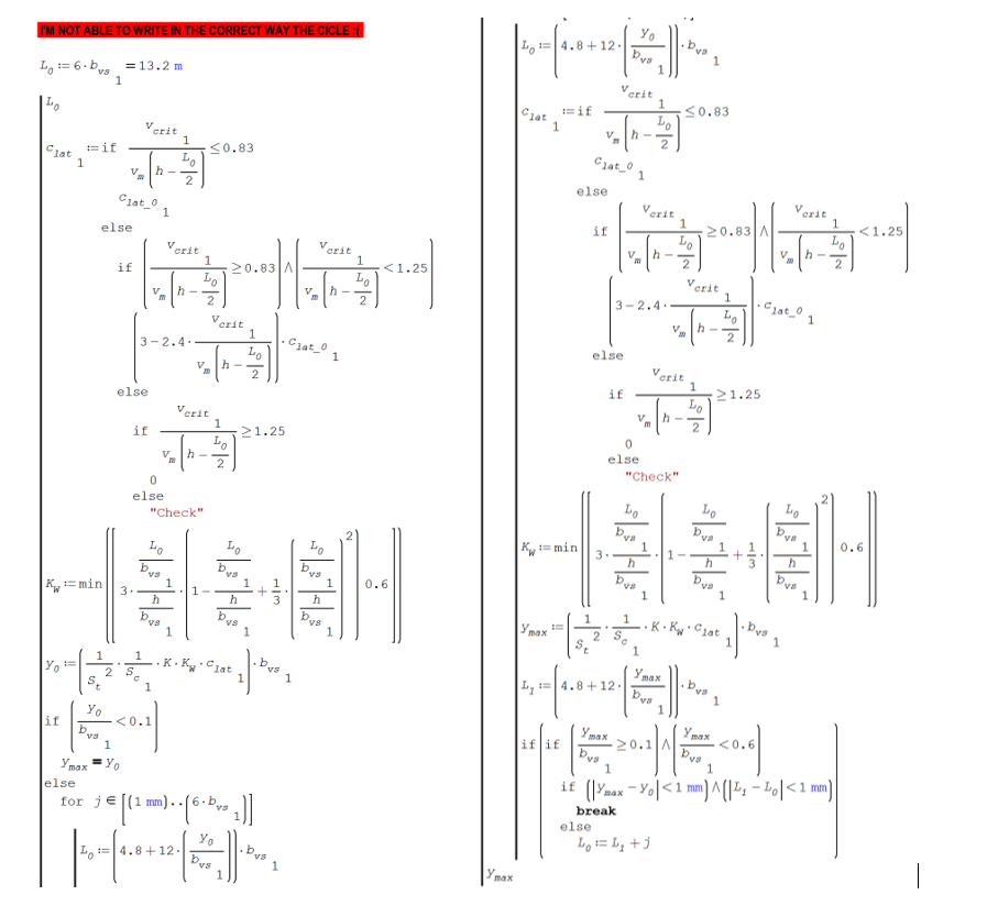

I reply here to your advices.
I tried to semplify the spreadsheet in order to focus aptention on the iteractive process that i'd like to assess.
I explicate even the main process that i tried to set into formulation but that doesn't works because i don't understand the correct syntax of a "for cicle"
All my consideration are into the smath file and summaryzed below.
If someone have time to take a look and fix the mistakes of the cicle only i'll be very gratefull.
I attached the simplify file below (always need to be opend in the same folder of related excel)
Ciclo for semplificato_R1.sm (5,47 МиБ) скачан 1530 раз(а).
413-Camino Alabama-Modale_R1.xlsx (300,5 КиБ) скачан 1098 раз(а).
Thancks for your time

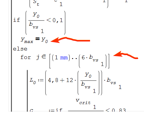

In fact I see at least two incorrect or suspicious situations:
1) what appears to be an assignment is performed with = instead of :=

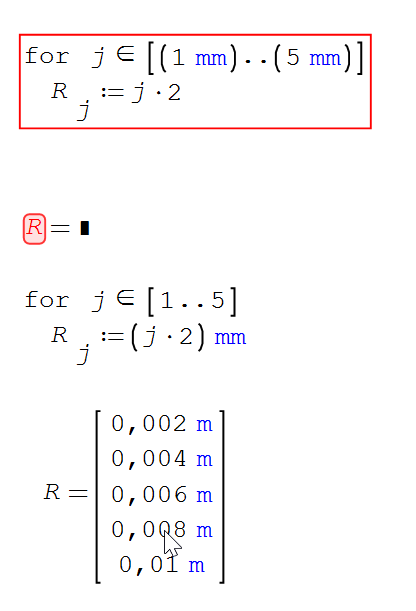

2) j of the for loop is a counter but here it is referred to as a series of values ​​with units of measurement. I'll show you a simple working example
Показать спойлер
Показать спойлер
