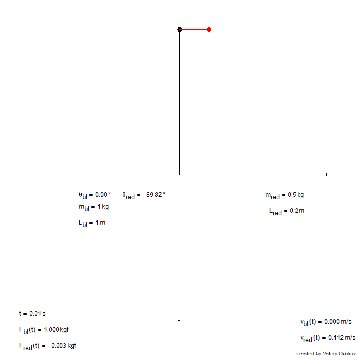

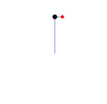

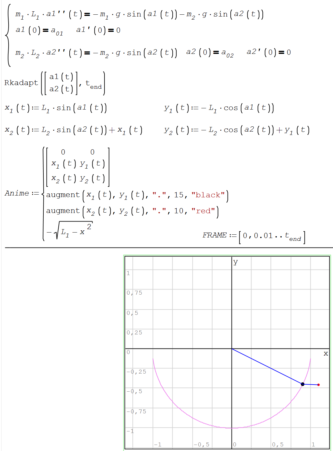

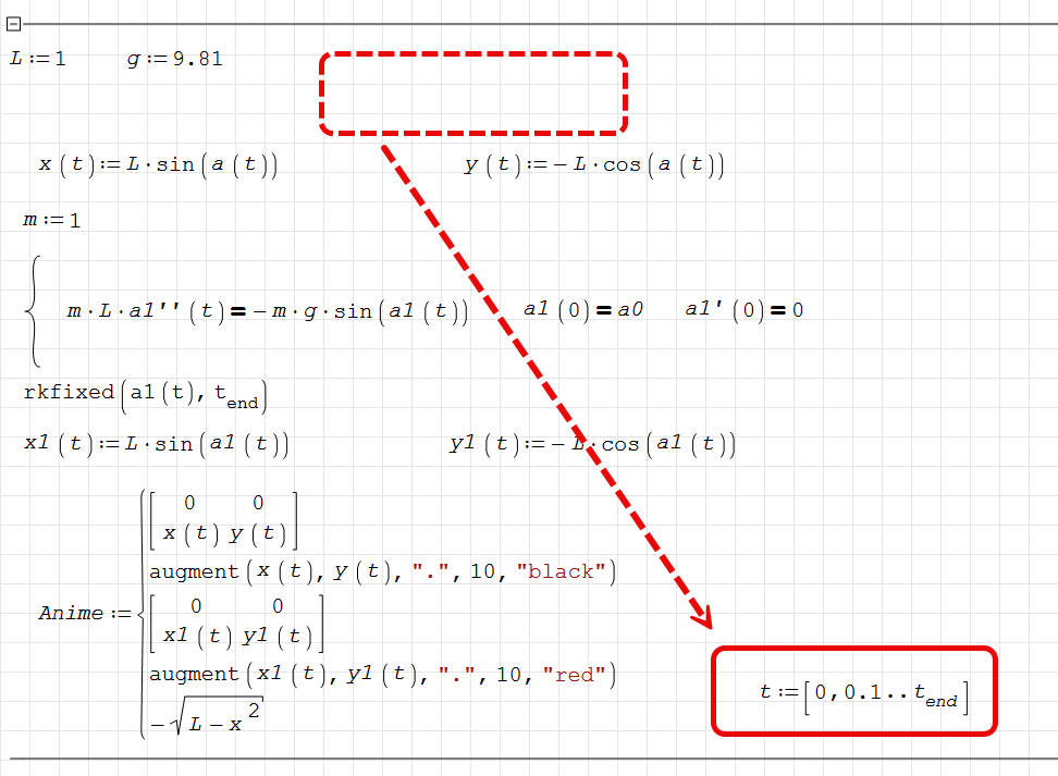

Hi friends!
Now I am on the forum again!
Anime2.sm (55,59 КиБ) скачан 935 раз(а).
But the model is not correct. See please Alvaro model!
Отредактировано 30.10.2025 19:22:14

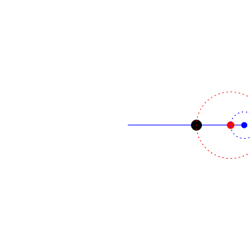

Using X-Y Plot
Anime2-xyplot.sm (57,84 КиБ) скачан 962 раз(а).
sergio 29.10.2025 14:50:17, Ricardo_Herrera 03.01.2026 14:15:17

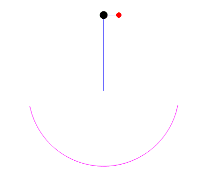

#4 Опубликовано: 29.10.2025 13:56:31
Valery Ochkov
Valery Ochkov
Anime-x-y-plot.sm (18,24 КиБ) скачан 912 раз(а).
And where here is a bug?
#5 Опубликовано: 29.10.2025 14:01:44
Vector t must be defined below before the component.
The animation feature is still being developed when I have time for it.
Отредактировано 29.10.2025 14:05:45
Alvaro 30.10.2025 07:04:42

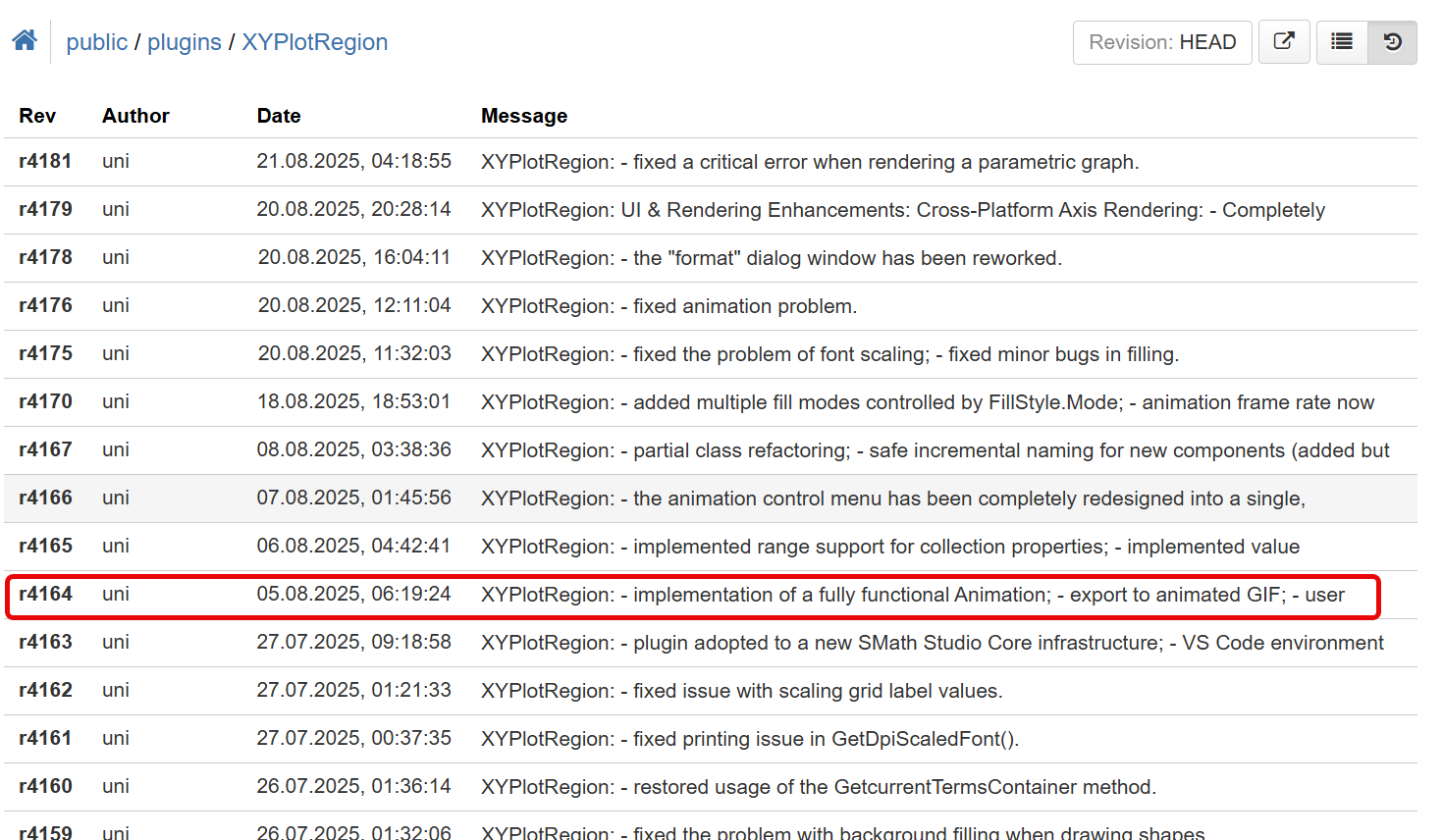

Слава, а когда этот новая версия плагина появилась?
#7 Опубликовано: 29.10.2025 18:19:29
В конце лета.

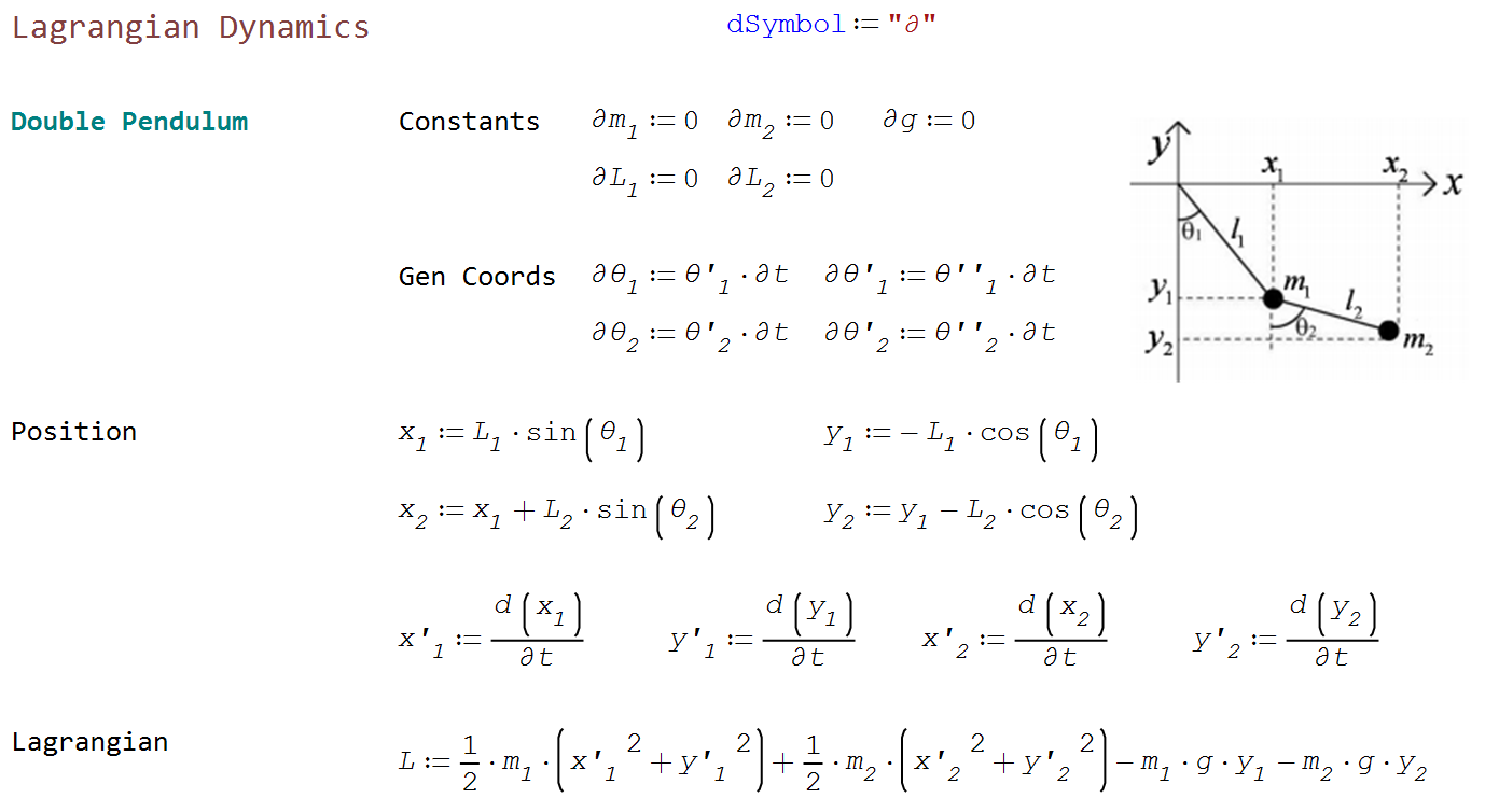

Hi. My approach to solving the double pendulum problem.
double_pendulum.sm (75,92 КиБ) скачан 974 раз(а).
Вячеслав Мезенцев 30.10.2025 09:13:40, sergio 30.10.2025 12:18:26, Valery Ochkov 30.10.2025 07:45:32

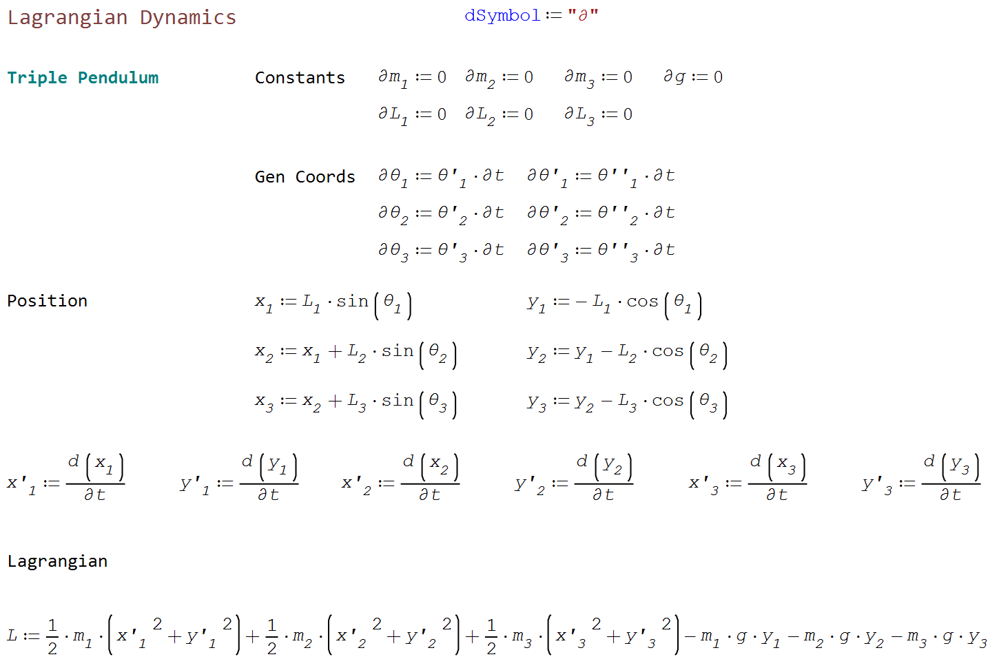

#12 Опубликовано: 31.10.2025 05:03:31

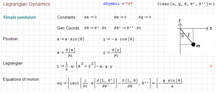

Hi. Using pure SMath code to deduce the equations of motion from the Lagrangian, with the functions in this post: https://smath.com/en-US/forum/topic/AeeMSM/Using-differentials.
double_pendulum_lagrangian.sm (174,64 КиБ) скачан 931 раз(а).
double_pendulum_lagrangian.pdf (503,4 КиБ) скачан 702 раз(а).
Valery Ochkov 31.10.2025 07:37:56, sergio 31.10.2025 08:48:37
#13 Опубликовано: 31.10.2025 05:10:58
Triple pendulum - see errors at the second haft of time interval.
I no longer use Mathcad, except on rare occasions, when I rely on Mathcad version 11, which I consider the last decent version. So I can't see the triple pendulum file. And I suppose this is the situation for many SMath users who no longer have Mathcad readily available. But more than worrying about the conservation of energy, which seems to be a problem with the numerical method used, I'm more surprised to see how the future affects the past, since the animation shouldn't alter the trajectories already described by the particles as time passes.
This is my approach to the triple pendulum.
triple_pendulum_lagrangian.sm (135,01 КиБ) скачан 921 раз(а).
triple_pendulum_lagrangian.pdf (248,09 КиБ) скачан 560 раз(а).
Отредактировано 31.10.2025 06:13:23
Valery Ochkov 31.10.2025 07:38:10, Вячеслав Мезенцев 31.10.2025 07:18:43

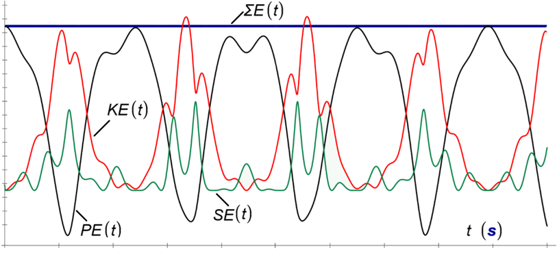

#17 Опубликовано: 01.11.2025 01:52:48
Valery Ochkov
Valery Ochkov
See pls pdf
With those values:

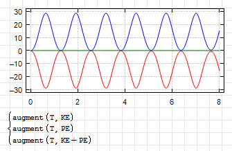

One my plot:
Change of three types of energy of a swinging pendulum on an elastic suspension - SE - the spring energy
Отредактировано 01.11.2025 01:55:02

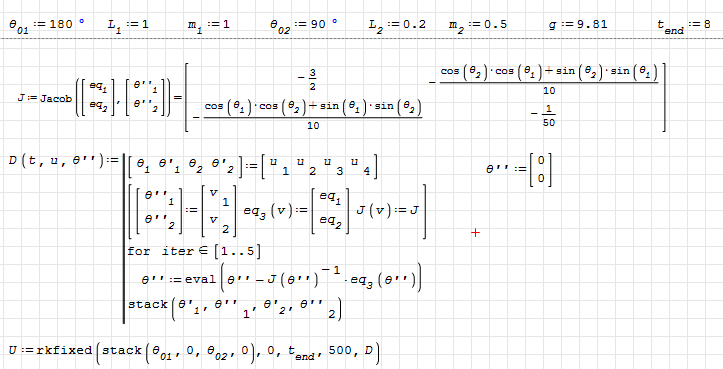

#19 Опубликовано: 06.11.2025 04:03:01

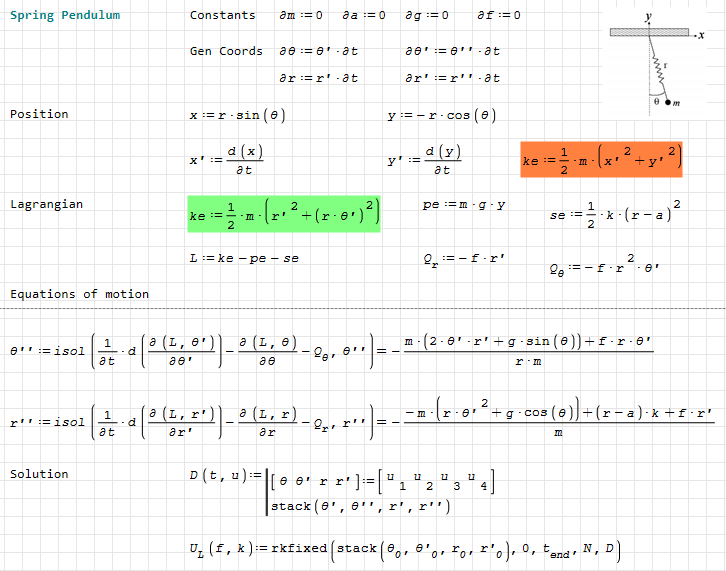

Hi Valery. For the single pendulum you can get the lagrangian from the olf post about differentials ( https://smath.com/en-US/forum/topic/AeeMSM/Using-differentials ) It's very simple and doesn't require much processing to use rkfixed.
For the double pendulum, you can use Newton-Raphson to solve the system within the function D. Here, a very simple version of the method is used.
double_pendulum_lagrangian-NR.sm (178,15 КиБ) скачан 912 раз(а).
Something similar applies to the pendulum with a spring. Note that the Lagrange equations become somewhat complicated because I use the x,y coordinates to calculate the kinetic energy, and SMath cannot simplify trigonometric functions. However, if you use r, θ' (in green), the equations of motion are greatly simplified. But that breaks the principle that the program should do the calculations, not the user.
Valery Ochkov 06.11.2025 05:16:18
