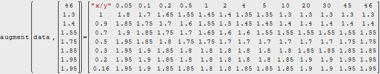

Awesome. When x=70, y=0.5, I need it to be 1.75 per code because x>45 but the function gives me 1.83. How would I modify the code for Spline to achieve this.
Obviously the function uses linear extrapolation beyond the limits of the data array.
Without touching the function you can enforce constant extrapolation by repeating the first or last rows or columns of data.
surface.sm (18,8 КиБ) скачан 1098 раз(а).
Tuan Nguyen 22.04.2021 18:37:00
Me feeling dumb. Thanks, Jean and MKraska
