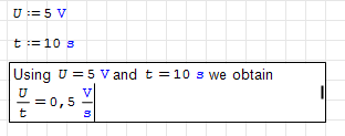

For now the best you can do is displaying the values in a common text region along with the formula and the result. That might be as good as substitution display for reviewers. It gives you full control over the display of the substitution values (dec prec and units) and of the result, separately.
