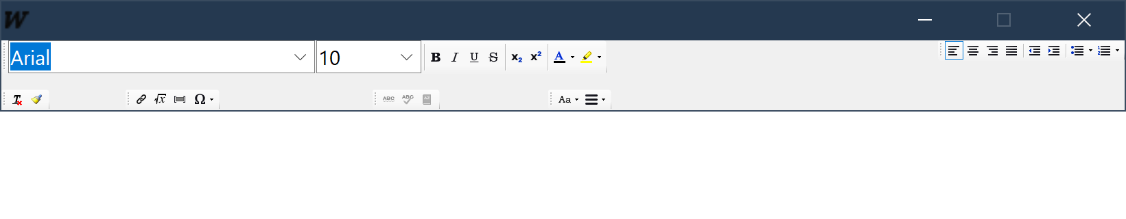

I'm using the excellent Writer Area and wish to spellcheck text within the area. I can open the Writer Area Settings toolbar but all of the spellchecking icons are greyed out. Is there soemthing special I have to do to make spell checking available?
So what's my set up?
Win 10 Home 1903 OS build 18362.476
SMath 0.99 build 7251
I have LibreOffice 6.2.8.2 with Marco A.G. Pinot English 2019.11.01 dictionary.
Here's a screen shot of the Settings Toolbar {the icons are tiny on my screen for some unknown reason}.
I guess there's a simple answer but I'm none the wiser!
Thanks.

Thank you for the pointer it has started to help. However, I'm stuck once more. In you documentation page 4 you discuss Global options gained from the toolbar "More" ...
I'm probably being particularly thick today but I don't see a More item on SMath menu bar, or as an item on any menu, and the Writer Region Settings toolbar has no menu at all. Without access to the global options I am unable to import a spell checking file.
Mike

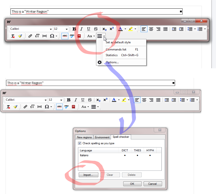

#4 Опубликовано: 19.11.2019 16:46:32
115 сообщений из 329 понравились пользователям.
This could help you
#5 Опубликовано: 19.11.2019 17:03:08
Mike Halliday
Mike Halliday
Thank you so much!
