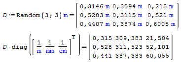

Assuming you have a table with columnwise uniform units, then the following approach provides full control:
exportdata.sm (4,81 КиБ) скачан 1042 раз(а).
