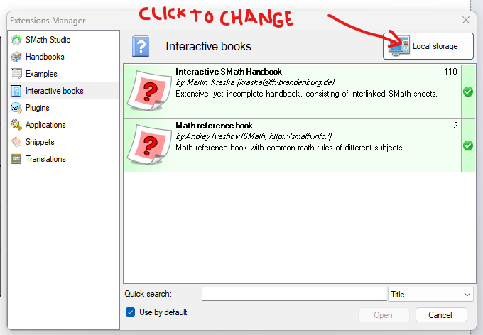

You can access to this interactive handbook via Tools-Plugins-Interactive Books
IMPORTANT
Check that the plugin Manager is pointing to "Online Gallery" not "Local Storage" as in my case, for that only click on that button
best wishes!

Thanks Oscar, but I think that this takes me to the handbook I already have - I get the message 'No updates found'.
The one referred to in the Youtube video is much larger (~500 files?).
Hello.
I think you checked "Interactive books" section instead of the "Handbooks" in the Extensions Manager.
But you can also download these documents with the following link: https://smath.com/en-US/licensing/api/Extensions?type=Handbook

The Interactive Handbook that is mentioned in the video, (and also I mention in my post), has 547 files.
