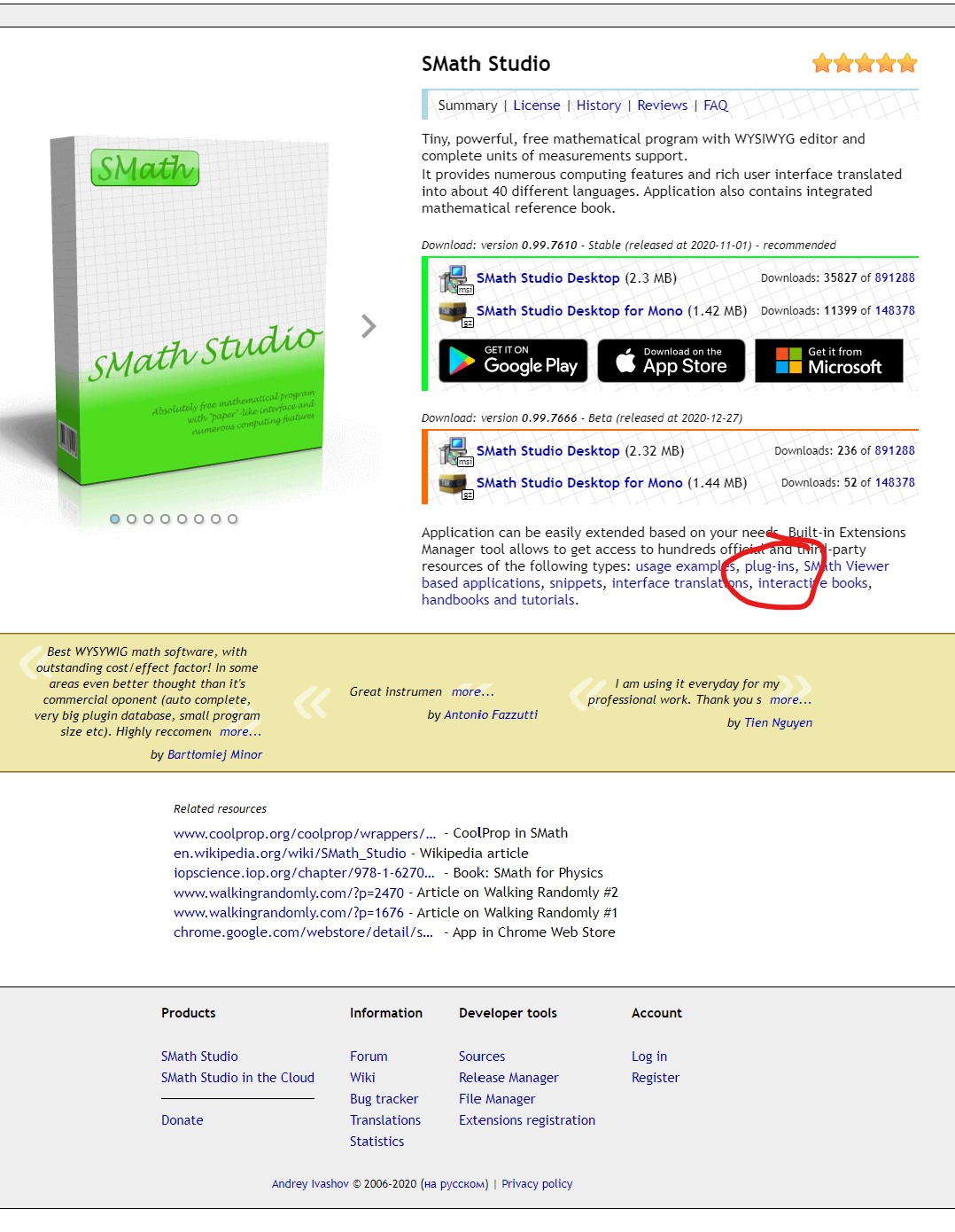

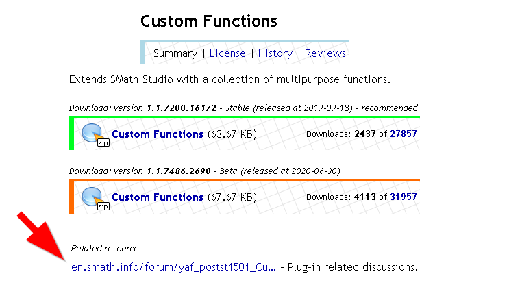

SMath Studio provides automatically an "extension's page" for each plugin (from the hompage click on the ]plug-ins link)
I usually add the link to the forum thread at the top of the "Related resources" section (this is up to each developer since cannot be automated).
About the units, I've not tested them with Imperial units as default, I'll check what can be done.

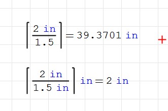

3. I have default set to imperial, but if I use a unit in the equation things seem to go array. Here is a photo:

1. When you say homepage. Are you referring to the en.smath.com/forum or en.smath.com/view/SMathStudio/summary Either way I don't see an "extension page" link.
I mean the landing page of https://smath.com
39.37in is 1m
This is because the function has 0.034m as input => ceil(0.034m)=1m
If I set the Units System to Imperial, I get 1ft as result, because the function read 0.167ft as input => ceil(0.167ft)=1ft
So it seems that the function works correctly with both the systems, but working with units everything is refered to the base unit (m or ft in this case); if you want to "round" a value associated to a multiple you have to divide by that unit inside the function and multiply again outside.

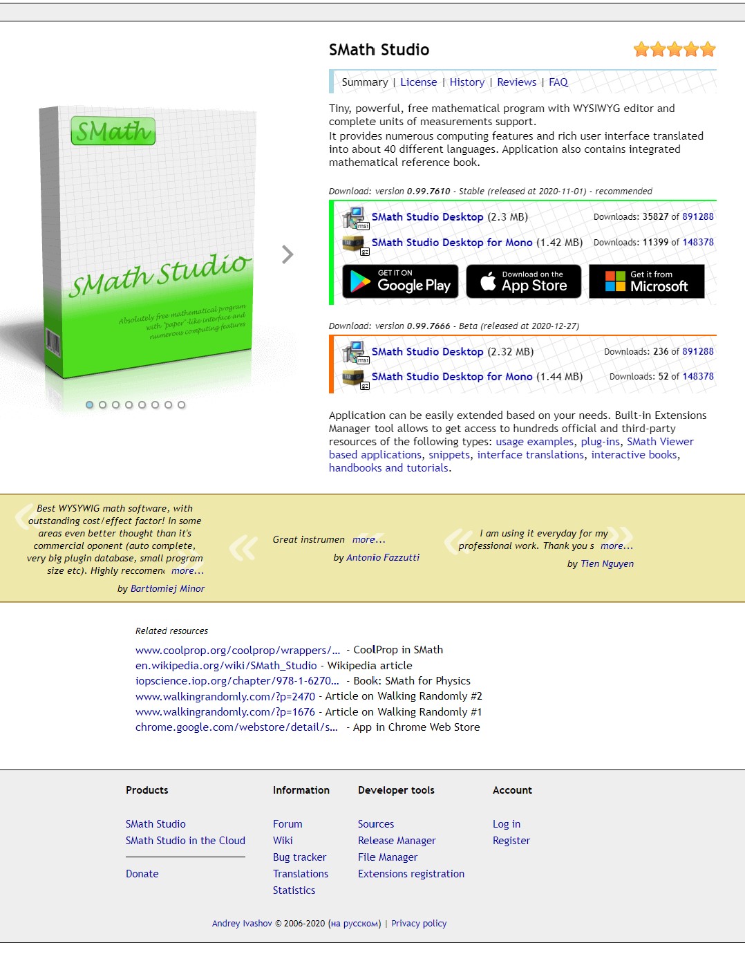

Davide - thanks again for the Reponses. When I try to go to "https://smath.com" I auto redirect to "https://en.smath.com/view/SMathStudio/summary" so maybe there is a difference.
Here is what I see:
#6 Опубликовано: 30.12.2020 14:03:25
Ryan Freund
Ryan Freund
Sorry, nevermind, I found it:
