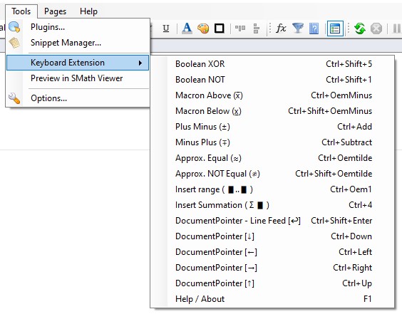

⚜ Kenny Lemens, P.E. ᵂᴵ 15.12.2022 11:09:00
Salutations!
If you are used to Mathcad 15.0, you will have difficulty Creating/Navigating a worksheet because SMath has limited support when it comes to hotkeys/keyboard operations. SMath requires a fair amount of operations to be achieved via the mouse [🖰], which can be annoying (and time consuming) if you wish to type a lot of math/text quickly.
Whereas I did identify some remedies/workarounds (i.e., insert ▮⊕▮ (xor Operator) via HEX code 00A4 [Currency sign symbol: ¤]), this remains a work-around and does not actually address the issue. Therefore, I developed the following code:
'VB.net - Framework 2.0; Windows 10 Pro x64; SMath 0.99.7822.147 [English, USA]
keybinding_with_IPluginMenuExtender.vb.txt (37,17 КиБ) скачан 675 раз(а).
Preview:
Q: ) Will you be deploying this as a SMath Extension?
A: ) No, I do not plan to. As to why, the reason is simple: I do not know how this plugin will behave across different languages/keyboard configurations/operating systems. Before I could release a plugin I am proud of, I would need to address the implications that will result from these different configurations. In addition, such a plugin would beg the developer to permit users to customize key bindings to any given action; I do not have the time to develop such a great utility. Finally: such a plugin has the dangers of being greedy; I would not be able to guarantee such a plugin to respect (either by yielding or overtaking) keystrokes reserved by any given plugin.
Q: ) Why is this code written in Visual Basic and not C++
A: ) VB.net is not the better language, but rather I cannot ignore the benefits of VB within my profession. It is easy to read, less prone to make syntax errors, has a large range of implementations from VBScript in Mathcad, to VBA in MSOffice, from VB6 to VB.net in VSTO/Desktop applications. With that being said, I will not be posting the C++ equivalent as I am not proficient in doing so; I apologize for the inconvenience.
With that being said, here are some of my 'lessons learned' during my research:
May this be of Good Help, Merry Christmas;
- Kenny Lemens, P.E. ᵂᴵ

''' <summary>Adds MenuButtons to the Menu Bar
''' MenuButtons are assigned Shortcut keys, to be used within a document (regions need not be selected)
''' Shortcut keys to Mimic some Mathcad 15.0 Keypresses, enhances ability to insert operators within SMath
''' MENU BAR BUTTON LAYOUT:
''' [Tools]
''' [Keyboard Extension]
''' - 「Ctrl」+「%」 :: Boolean XOR (Exclusive or)
''' - 「Ctrl」+「!」 :: Boolean NOT
''' - 「Ctrl」+「-」 :: Insert a Macron (bar) Above the Previous Character
''' - 「Ctrl」+「_」 :: Insert a Macron Below (undlerline) Above Previous Character
''' - 「Ctrl」+「+」numpad :: Plus Minus Sign (Returns a set of 2: the sum And difference)
''' - 「Ctrl」+「-」numpad :: Minus Plus Sign (Returns a set of 2: the difference And sum)
''' - 「Ctrl」+「~」 :: Approximately Equal to (「Ctrl」+「Alt」+「=」)
''' - 「Ctrl」+「Shift」+「~」 :: Approximately NOT Equal to
''' - 「Ctrl」+「;」 :: Range variable [a .. b] (step = 1)
''' - 「Ctrl」+「4」 :: Vector sum
''' - 「Ctrl」+「Shift」+「Enter」 :: Move ✛ to Start of Next Line (Line Feed & Carriage Return Only) "Ignore Region Interaction" Mode --- DocumentPointer - Line Feed [↩]
''' - 「Ctrl」+[↓] :: Enter "Ignore Region Interaction" Mode --- DocumentPointer [↓]
''' - 「Ctrl」+[←] :: Enter "Ignore Region Interaction" Mode --- DocumentPointer [←]
''' - 「Ctrl」+[→] :: Enter "Ignore Region Interaction" Mode --- DocumentPointer [→]
''' - 「Ctrl」+[↑] :: Enter "Ignore Region Interaction" Mode --- DocumentPointer [↑]

Preview:
[Tools]→[Keyboard Extension] (by lemensk)
author: Kenneth M. Lemens (username: lemensk)
date: 2022-12-15
type: IPluginMenuExtender
summary:Adds MenuButtons to the Menu Bar (w/ hotkeys):
Hotkeys work within region, or creates a new region
https://en.smath.com/forum/Default.aspx?g=posts&t=23271
|| MENU BAR BUTTON LAYOUT ||
[Tools]
- 「Ctrl」+「%」 - ▮⊕▮ Boolean XOR (Exclusive or)
- 「Ctrl」+「!」 - ¬▮ Boolean NOT
- 「Ctrl」+「-」 - x̅ Insert a Macron Above
- 「Ctrl」+「_」 - x̲ Insert a Macron Below
- 「Ctrl」+「+」numpad - ±▮; ▮±▮ Plus Minus Sign
- 「Ctrl」+「-」numpad - ∓▮; ▮∓▮ Minus Plus Sign
- 「Ctrl」+「~」 - ▮≈▮ Approx. Equal to (「Ctrl」+「Alt」+「=」)
- 「Ctrl」+「Shift」+「~」 - ▮≉▮ Approx. NOT Equal to
- 「Ctrl」+「;」 - ▮..▮ Range Function
- 「Ctrl」+「4」 - Σ▮ Vector Sum
- 「Ctrl」+「Shift」+「Enter」 - Move ✛ to Start of Next Line
- 「Ctrl」+Arrows - Ignore Regions when moving cursor
Press [Ctrl]+[C] to Copy this message to your clipboard...

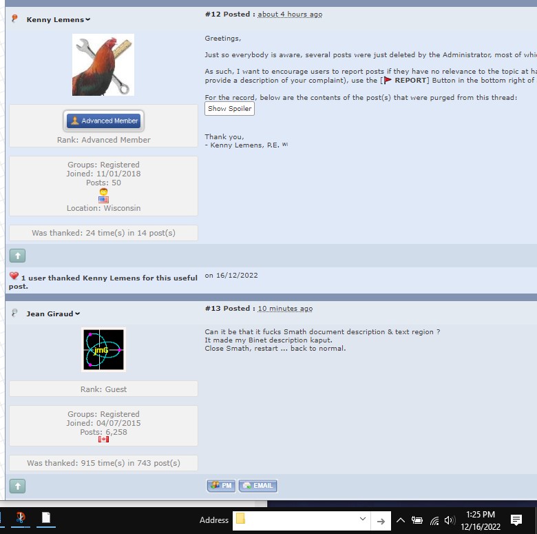

Greetings,
Just so everybody is aware, several posts were just deleted by the Administrator, most of which were off topic and had no correlation to keyboards/keybindings. However, one post did contained profanity.
As such, I want to encourage users to report posts if they have no relevance to the topic at hand; the Administrator has the discretion to transfer/edit/delete depending on the complaint/merits. To report a post (and provide a description of your complaint), use the [🚩 REPORT] Button in the bottom right of any post.
For the record, below are the contents of the post(s) that were purged from this thread:
Thank you,

hi, Kenny Lemens, Sorry, I'm new to SMath, how do you use that code in SMath to have those keyboard shortcuts??
There is an SMath sheet on how to input operators with the keyboard: https://smath.com/files/Download/YmZbT/Help.sm.
See also the corresponding wiki page: https://wiki.smath.com/en-US/Keyboard_Shortcuts
