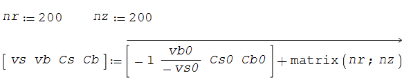

I have say, 4 matrix, size of (nr, nz). I am trying to do initiation of these 4 matrix, vs, vb, Cs, Cb. In mathcad, you create a matrix of 4 column and 1 row, representing these 4 matrix, and initiate with for loop.
matrix initiate
Smath didn't show any errors. But when I tried to display the values of one matrix, say, vs=, nothing show up.
I thought Smath might treat all variables as global variable, so, I tried anther way:
2nd try
Then the error showed up, "requested matrix element doesn't exist".

Hi. SMath matrix index starts at 1, not at 0. If you want to translate Mathcad code into SMath, try to use ORIGIN:=1 in Mathcad, because x[0] always gives an error in SMath.

Thanks a lot. Following your instructions, I started to initiate from 1, using the 2nd picture, instead of 0. It worked.

As side note, you might initialize you matrices even like this:
