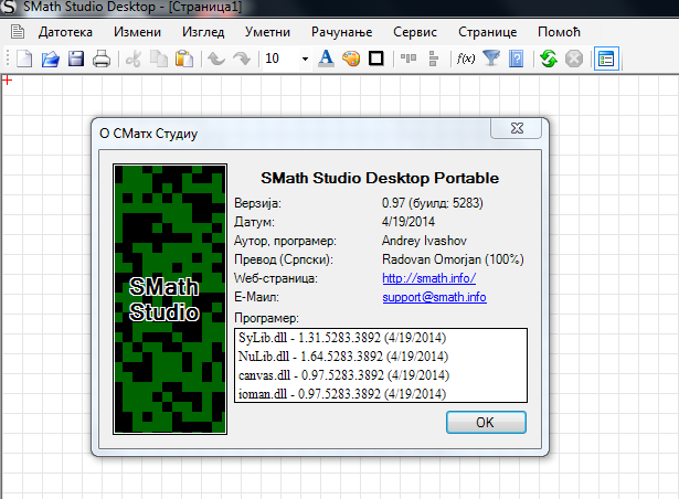

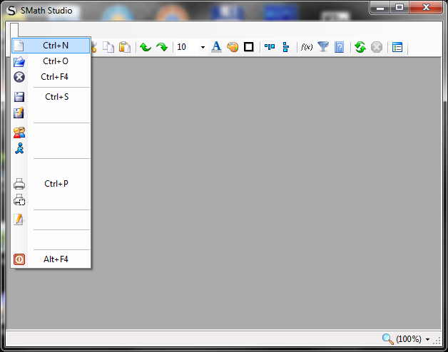

Did anyone experience this Unhandled exception when just trying to change the language interface. When ignoring it, then SMath appeared quite strange - see the picture. Also, see the video on this link changing languages problem (~5min long)
Here are the messages accompanied with this Unhandled Exception:
(x64 Win7)
Показать спойлер
#11 Опубликовано: 11.07.2014 09:28:48
mhhh... I can't replicate your issue, I've tried with a lot of languages. Have you customized some units xml file?
#12 Опубликовано: 11.07.2014 10:33:00

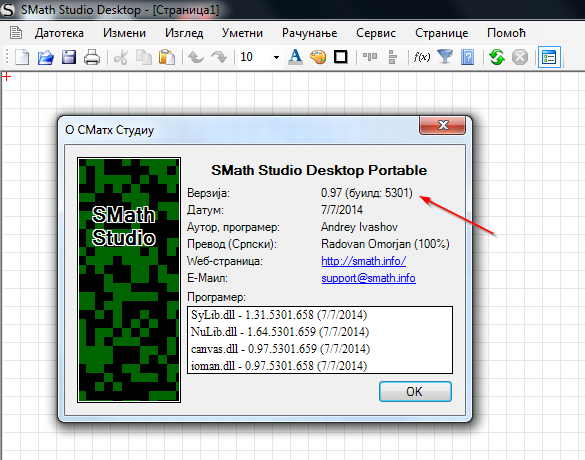

No, I did not do anything like this. Strange, but it happened to my home computer as well (x86 win7) and this nightly build. This happened when you I choose my languages (). It puzzled my more when I managed to use other languages but mine . On the other hand, I have no notification of the changes will have affect after restarting SMath when changing to Srpski or Српски contrary to other languages when I have this notification
Just to note, SMath portable by Martin (2014 06 21 SMath and Maxima) had no problems at all - see the picture.
