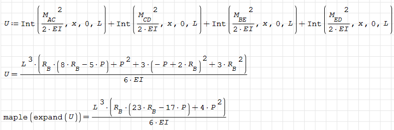

Thank you very much. I could expand my equation like below.
one more question please..
Can I expand it in smath studio like in my Ti nspire result?
Отредактировано 07.12.2025 04:02:01
#4 Опубликовано: 07.12.2025 12:11:01
Maybe, you just have to switch Optimization> None in the context menu. SMath's symbolic "optimization" sometimes rolls back external expansion with Maple or Maxima.

#5 Опубликовано: 11.12.2025 03:57:14
kimkim
kimkim
0 сообщений из 9 понравились пользователям.
Thank you, Вячеслав Мезенцев & Martin Kraska.
I count get the same result by your way.
The solution was "optimizaion>None"!!
