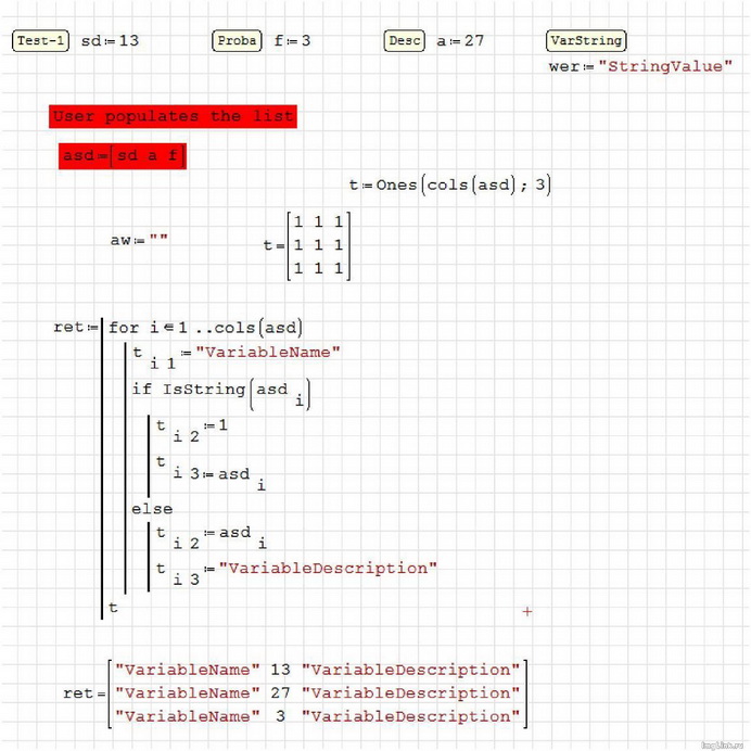

Hello Davide!
For my program StandardProject
(see the topic in Extensions)
For data exchange
the user generates a matrix
In the columns which
1 column - the name of the variable as a string
2 column - variable value as double
3 column - description as a string
to simplify and reduce errors
I was planning to write a function
which input received the list of variables
and the output was formed by the above matrix
With best wishes!

I don't understand the request .
Inst_Colebrook Pipe Data.sm (60,08 КиБ) скачан 1161 раз(а).
#6 Опубликовано: 27.02.2017 12:37:34
unfortunately this won't work; once passed through the function even descriptions will be lost (because the values are passed on evaluation, inside the function nothing is known but the values).
My suggestion is to create a function f(name,description,value) to create your matrix; function can be extended to 3 lists using vectorize() (or built directly to handle vectors). (or you can try to follow the hint given by uni).

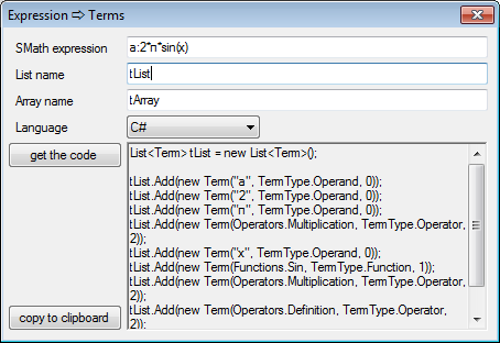

Just for curiosity and without any insight into real plugin-coding: Isn't the programmatic representation of the expressions as required in the script region that what the "Expression -> terms" dialog in the Development tools produces?
Is there a need to change the values for "List name" and "Array name"?

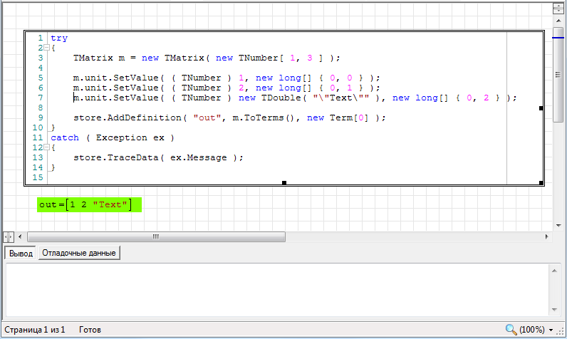

There are several ways how to use Script region.
Example 1.
try
    TMatrix m = new TMatrix( new TNumber[ 1, 3 ] );
    m.unit.SetValue( ( TNumber ) 1, new long[] { 0, 0 } );
    m.unit.SetValue( ( TNumber ) 2, new long[] { 0, 1 } );
    m.unit.SetValue( ( TNumber ) new TDouble( "\"Text\"" ), new long[] { 0, 2 } );
    store.AddDefinition( "out", m.ToTerms(), new Term[0] );
catch ( Exception ex )
    store.TraceData( ex.Message );

#13 Опубликовано: 01.03.2017 05:32:40
Kross
Kross
To uni
it's great
how do I output the variable in the field Smath Studio - understand

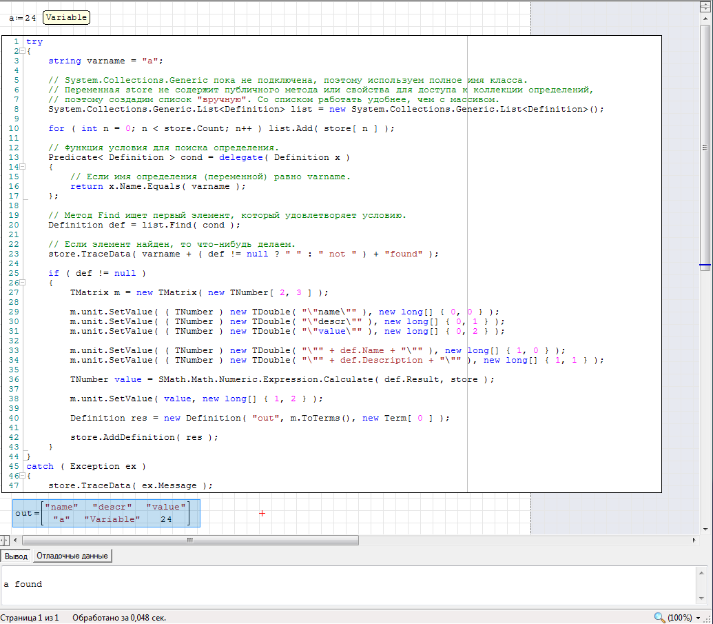

Example 2. How to get definition by name
try
    string varname = "a";
    // System.Collections.Generic пока не подключена, поэтому используем полное имя класса.
    // Переменная store не содержит публичного метода или свойства для доступа к коллекции определений,
    // поэтому создадим список "вручную". Со списком работать удобнее, чем с массивом.
    System.Collections.Generic.List<Definition> list = new System.Collections.Generic.List<Definition>();
    for ( int n = 0; n < store.Count; n++ ) list.Add( store[ n ] );
    // Функция условия для поиска определения.
    Predicate< Definition > cond = delegate( Definition x )
        // Если имя определения (переменной) равно varname.
        return x.Name.Equals( varname );
    // Метод Find ищет первый элемент, который удовлетворяет условию.
    Definition def = list.Find( cond );
    // Если элемент найден, то что-нибудь делаем.
    store.TraceData( varname + ( def != null ? " " : " not " ) + "found" );
    if ( def != null )
        TMatrix m = new TMatrix( new TNumber[ 2, 3 ] );
        m.unit.SetValue( ( TNumber ) new TDouble( "\"name\"" ), new long[] { 0, 0 } );
        m.unit.SetValue( ( TNumber ) new TDouble( "\"descr\"" ), new long[] { 0, 1 } );
        m.unit.SetValue( ( TNumber ) new TDouble( "\"value\"" ), new long[] { 0, 2 } );
        m.unit.SetValue( ( TNumber ) new TDouble( "\"" + def.Name + "\"" ), new long[] { 1, 0 } );
        m.unit.SetValue( ( TNumber ) new TDouble( "\"" + def.Description + "\"" ), new long[] { 1, 1 } );
        TNumber value = SMath.Math.Numeric.Expression.Calculate( def.Result, store );
        m.unit.SetValue( value, new long[] { 1, 2 } );
        Definition res = new Definition( "out", m.ToTerms(), new Term[ 0 ] );
        store.AddDefinition( res );
#15 Опубликовано: 01.03.2017 07:05:14

#16 Опубликовано: 01.03.2017 07:43:44
