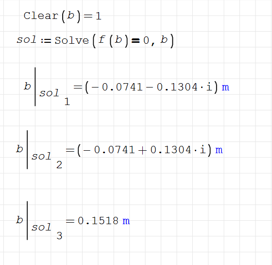

Dear all, 1st off - I am new to SM and experienced this problem with simple structural stress equation (stress due to bending) that I am unable to resolve - see attached. Solver returns error "No real roots".
I know there is as solution but I am unable to accomplish it.
Q1: Please advise - what am I doing wrong?
Q2: What is a best way to solve this as a system of equations (instead of substitution in order to arrive to a single eqn presented)?
Thanks!

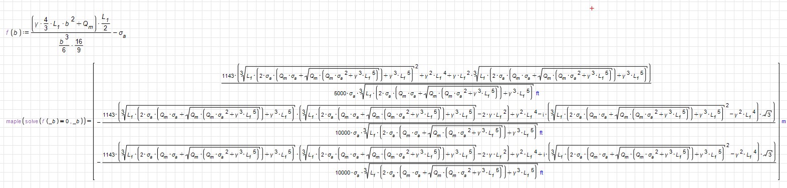

You will notice a lot of different approaches; I am personally bias to using maple to solve these problems (In order to run maple functions, you need to install the "Maple Tools Plugins" )

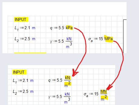

[Using Maple]: Since you already constructed f( b ), all you need to do is perform a symbolic evaluation (keypress [Ctrl] + [.] instead of [=]). This will produce the following:
NOTE: you cannot have any of the variables defined, else those values will be treated as constants and thus substituted into the equation.
You can copy the text below and paste it into your worksheet; this will generate the result based off of your variables (I work in imperial, thus 'ft' is referenced):
This brings us to units; by solving symbolically, you can identify those variables where the units "don't match". It looks like pressure is your culprit...
I haven't had much success using pressure with regards to force; there is something with regards to the gravitational constant that doesn't quite work right. Therefore, I consider pressure to be of units force/area instead of mass/area. This will cause the units of your inputs to change as such:
I hope this Helps!
-Kenny Lemens, P.E.
{1143*((nthroot(L.1*(2*σ.a*(Q.m*σ.a+sqrt(Q.m*(Q.m*σ.a^2+γ^3*L.1^5)))+γ^3*L.1^5),3))^2+γ^2*L.1^4+γ*L.1^2*nthroot(L.1*(2*σ.a*(Q.m*σ.a+sqrt(Q.m*(Q.m*σ.a^2+γ^3*L.1^5)))+γ^3*L.1^5),3))}/{5000*σ.a*nthroot(L.1*(2*σ.a*(Q.m*σ.a+sqrt(Q.m*(Q.m*σ.a^2+γ^3*L.1^5)))+γ^3*L.1^5),3)*'ft}
I hope this Helps!
-Kenny Lemens, P.E.

Thank you for your solutions! I like the elegance presented which answers my question Q2 above on substitution.
Re units / unitless project:
I eventually managed to solve it with polyroots (before reading your posts) after rearranging the eqn in the form of polynomial order b^3 (disadvantage: I do the math instead of SM..).
What I noticed is that with units result is 0.152 m while unitless returns value 3.8664 ratio of these being 25.47 which is (close to) units ratio mm/inch.
Coincidence or Bug?
How can one be sure on the output in case of professional application ?
Real world example of not using units properly and catastrophic outcome here https://www.wired.com/2010/11/1110mars-climate-observer-report/ and the same topic on YouTube video "Advanced Problem Solving with PTC Mathcad" @ 4th min.
Nostalgic side note: my old handheld hp48 returns correct result (0.152 m) in no time.

Thank you Sergio! I like the elegance presented.
However, changing initial guess value (b0) returns different results...(?)
For [b0] between 1 mm to 300 mm result is 152 mm while for b0=500 mm returns 145 mm, for b0=600 mm result is -39 mm. (?)
What is going on here?
Why this sensitivity to initial values and different results ?
These are non -linear equation, the solutions also depend on the research interval (especially with numerical solution methods) it is appropriate to proceed with a sanity check and sometimes trace the graph of the function to identify the search interval.
