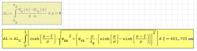

An example of my practice is here:
First formula is a classic Strength of Materials one, with units inside. In the second formula, I operated some transformations, targeting to avoid units inside the integral, making it so more robust.
