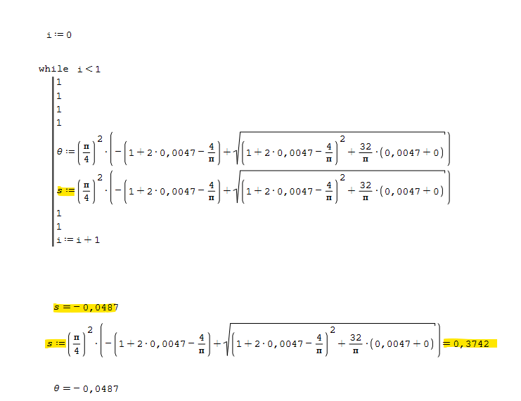

Hey,
is there are maybe a bug? or where is my mistake? why i got different results?

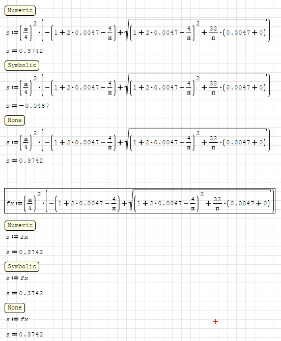

Symbolic calculation is wrong.
Possibly a bug, developer need to check.

hey overlord,
thanks a lot for your help. yea, that was the problem. i changed it now from symbolic to numeric.

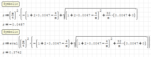

I got one better. eval() makes symbolic calculation correct.
Don't know what is going on, but it is obviously a bug.
