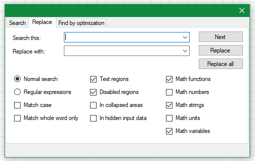

Yes.
In a single math region, you can use the F8 key an you'll be able to rename all local variables/functions at once.
Globally, you can do it with the Text Region Utilities plugin.

#4 Опубликовано: 09.04.2019 15:34:12
In a text region, nothing happens if I push "F8".
True, edited.
Also, I have the text region utilities plugin on SMath, but don't know how to access it in the sheets.
Go to "Insert" > "Text region utilities" > "Toolbox"
This will add a small region in the worksheet. Right clik on the region to access the "Search and replace" dialog. You might have to evaluate the worksheet to make it working properly.
Also, I was also asking how to do this in an actual formula, not a text region.
Both F8 and the TRU dialog are able to do that, just play with the options (uncheck "Text regions", check meaningful math options).

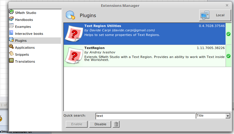

Arie
Arie
It may be necessary to restart SMath if you just installed Text Region Utilities.
#15 Опубликовано: 09.04.2019 17:45:11
The Cross
The Cross
0 сообщений из 73 понравились пользователям.
I installed it about 3 weeks ago, and have restarted the computer every day since.
#16 Опубликовано: 09.04.2019 18:35:10
I don't know what is going on, because, the "standard ToolboxButtons" addin is there, and enabled, but it does not come in on the pulldown menu under insert.
"Standard Toolbox Buttons" is the built-in plugin that handles the callapsible palettes on the right of the screen (Arithmetic, Matrices, Booleans, etc...)
Text region Utilities is a different addin and provides (even) the "toolbox region".
If you search "text" in your extensions manager and you have the plugin installed you should see something like this (SS 0.99.7005):
