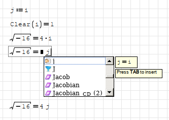

You can't totally remove i assign.
Or swap i with j via editing Constants.xml.
It is hard-embedded to smath code.
Clear(i) gives 1, which falsely results as it worked.
But it won't actually be removed by Clear().
However, you can assign sqrt(-1) or i to j.
Results placeholder can be edited with j.
And you can reassign you i result to j.
#4 Опубликовано: 10.03.2023 17:31:59

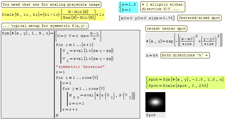

As well, 'i,j' are largely used by Smath original Designers
and the Smath Community as rows/cols indices.

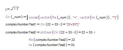

⚜ Kenny Lemens, P.E. ᵂᴵ
Greetings,
For the first part:
...we use i to represent current...Thanks in advance!
To get 'I' to be your default unit for Amp, just modify the 「C:\Program Files (x86)\SMath Studio\entries\Units.xml」 as shown below:
NOTE: if you accidently corrupt this file (i.e., SMath will not even load), you can just re-install SMath as every new install will rewrite/replace the Units.xml file.SMath_DefaultUnitsOfAmp.jpg
Показать спойлер
As for the second part:
... j to represent the imaginary unit...
As stated, you cannot replace 'i' as the Special Variable. However, there are some trick you can use (depending on your purposes):
First: define 'j as the imaginary unit; copy and paste the following:
Цитата
'j:sqrt(-1)
Next: define a function, similiar to this:
Cn(_num):line(concat(var2str(Re(_num)),"\002B\",var2str(Im(_num)),"\002A\\0027\j",1,1)
With this defined at the top of your sheet, you can display your number (as a string) in the syntax you desire. To use it as a mathematical expression, just use the str2num() function to convert it into math. NOTE: for this to 'work,' you need to have the 'Custom Functions' plugin installed:
May this be of Good Help!
- Kenny Lemens, P.E. ᵂᴵ
