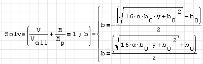

#105 Опубликовано: 18.04.2014 19:00:08
solve() is the SMath built-in numeric solver.
You want Solve().

#106 Опубликовано: 18.04.2014 21:39:35
Alexander O. Melnik
Alexander O. Melnik
mkraska,
That explains why solve() function did not work, however it does not explain why Maxima(solve())= function did not work - it should have passed solve() to maxima in which solve() is correct syntax.
Thank you for your help!!!

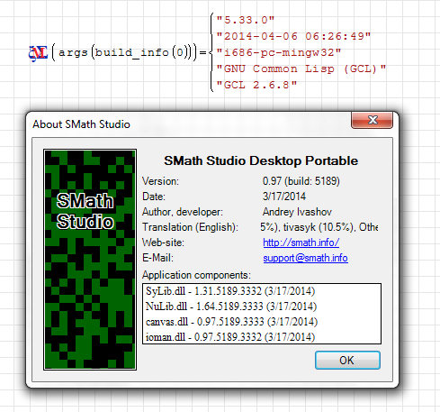

Here is another portable SMath with Maxima.
- unzip the file wherever you want (space requirement 140 MB
- launch the executable in SMath\2014 04 17 SMath 0.97.5189 Portable
You also can run wxMaxima in SMath\Maxima-5.33.0.1\wxMaxima
As a test you might run the attached file. The package contains an experimental version of the Maxima plugin, some of the features (in particular the file format of plot regions) may change.
There are stability issues with the draw functions. They can crash Maxima and sometimes SMath if their input is not defined.

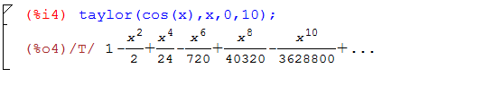

#117 Опубликовано: 06.05.2014 12:26:55
patel75
patel75
I've just restarted SMath after a break of a couple of years and am finding the Maxima plugin is the best thing in SMath since I last used it.
I do however have a minor problem. When doing a taylor expansion, the expression displayed by SMath is being factorised. This is quite annoying for me and I would like to know if there is a way to display the expansion is the standard format as displayed by Maxima. See below.
SMATH output
Maxima Output
#118 Опубликовано: 06.05.2014 12:49:08
SMath Optimization should be suppressed when using Maxima plugin. Right click on the Maxima region and choose Optiization|None
[MATH=eng]Maxima(taylor(g(x),x,0,10))=1-{x^2}/2+{x^4}/24-{x^6}/720+{x^8}/40320-{x^10}/3628800[/MATH]

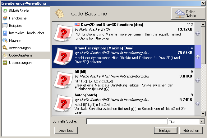

I've uploaded a snippet with descriptions for Maxima Draw2D and Draw3D graphic options and objects. Thus they are known to the dynamic assistant for hints on syntax and for auto-completion.
Shortcut is "Draw"
