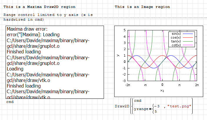

mhhhh.... Can see just error messages...
Martin Kraska 04.08.2014 10:21:00
#142 Опубликовано: 04.08.2014 09:51:39
This looks like you have tried the VTK interface in the same Maxima session (SMath instance). In order to revert to gnuplot interface for Draw you might restart Maxima using MaximaControl("restart" ) or open the update message in a virgin SMath instance.

#144 Опубликовано: 04.08.2014 10:36:58
I've simply opened you attachment (no further SMath instances running)
MaximaControl("restart") doesn't help
I attach the log.
Best regards,
Davide
Maxima.txt (3,54 КиБ) скачан 1362 раз(а).
#145 Опубликовано: 04.08.2014 11:13:28
I attach the log.
Testing was done using the portable distribution (Maxima 5.33.0), updated to the current SMath release candidate.
The log shows that you are using Maxima 5.31.1-1.
Update of the portable distribution is straightforward: Just take the SMath linux tarball and copy it's contents to the install dir of the portable distribution.

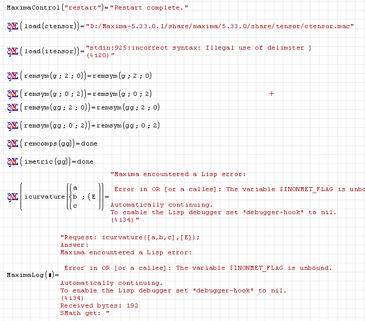

I am wondering if this maxima example could work on smath maxima ?
http://www.vttoth.com/CMS/projects/61-the-maxima-computer-algebra-system
#148 Опубликовано: 27.08.2014 14:23:59
I just gave it a try, see the result in the attachment. The packages seem to load despite the odd error message, probably due to a output parsing problem in the plugin.
The plugin, however, is not to blame for the failure of the icurvature command. It is correctly translated (had to use capital E in order to avoid translation into %e).
I used recent SMath studio and Maxima 5.33.0 as in the portable distribution.
If tensor stuff with co- and contravariant indices would work, one could think of providing a nice operator form via functions extensions. But it might be hard to tell these indices from ordinary matrix indices, subscipts or just exponents.

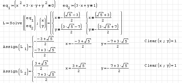

Hello, mkraska, got a question for you.
Does current implementation of maxima "Solve" function permit solving of system of equations (linear or non linear)?
If not, what command may I use?
Thank you!
#151 Опубликовано: 22.09.2014 15:09:02
Thank you!
Yes, this should normally work. There is an example in the Solve() handbook page, see [?]> Function index> S> Solve()

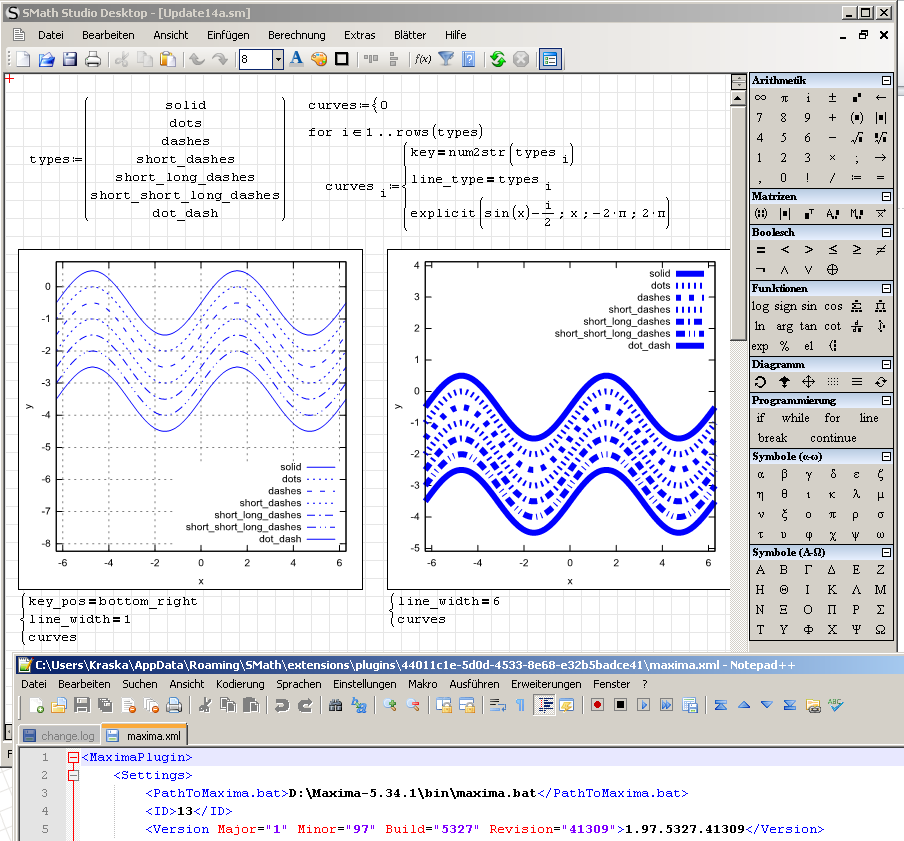

Sorry if this is already covered, but I installed this today and it works but every time I start SMath it stops working and says
Цитата
Cannot find maxima.bat
Cannot find maxima.bat. Do you want to enter a start search path now?
Yes No
in "Path to Maxima" it says "...Program Files (x86)\Maxima-5.30.0\bin\maxima.bat" which is correct.
if I push "Select Folder" and navigate to that same folder again it says Starting Maxima and then
Цитата
Path to Maxima
Found "..\Maxima-5.30.0\bin\maxima.bat".
OK
then if I recalculate the page it works. Then if I restart Smath, it asks for the path again.
(btw when I hit "thank you" button here in the forum I get an error).
Me too.
#154 Опубликовано: 13.11.2014 19:11:01
I recommend to use the pre-configured portable version (see signature)
#155 Опубликовано: 13.11.2014 20:18:22
zapzapouch
zapzapouch
0 сообщений из 27 понравились пользователям.
Well I already have Maxima installed, I can't just use the existing installation?
#156 Опубликовано: 14.11.2014 09:02:46
I can reproduce the problem. It happens because the settings window sometimes replaces the path to maxima by a relative one (as required for a portable version). For the desktop version this is a bug. Nonetheless you can enforce the correct absolute path to maxima by either correcting the entry in the settings window or by directly editing maxima.xml in the extensions directory structure.
Next time I open the settings window it's back to the relative path, though.
Where is that? I can't find it.
Цитата
If I remember correctly, Maxima version 5.30.0 had problems with the draw package.
They just released maxima-5.34.1 so I'm on that now.
#158 Опубликовано: 14.11.2014 13:14:52
zapzapouch
zapzapouch
Found it.
~\AppData\Roaming\SMath\extensions\plugins\44011c1e-5d0d-4533-8e68-e32b5badce41\maxima.xml
and changed it to:
C:\Program Files (x86)\Maxima-5.34.1\bin\maxima.bat

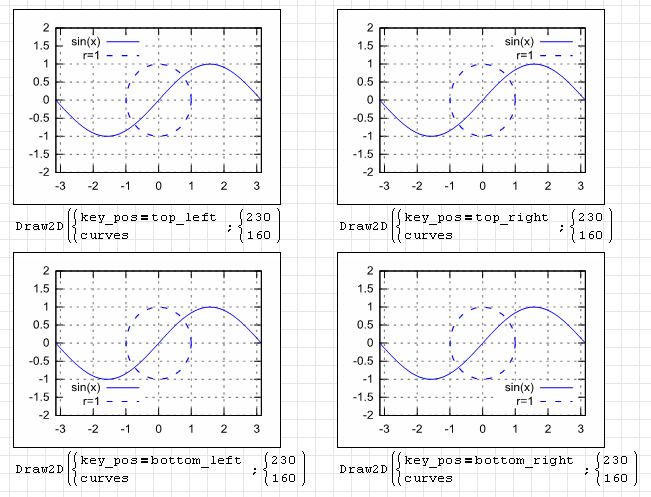

Based on the brand new windows installer for Maxima 5.34.1 the portable distribution has been updated. There are some new features in the draw package which can be used in SMath Studio:
- new option key_pos for placement of the legend
- support of more line styles for svg image format
Radovan Omorjan 16.11.2014 05:01:00
