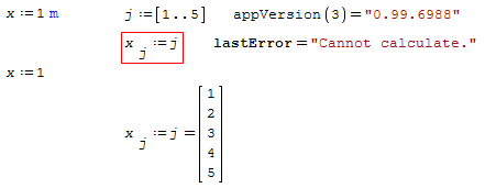

if x is 1m, the loop fails, if x=1, it succeeds. Any idea, what is going on? How to explain?
unit-range.sm (4,53 КиБ) скачан 732 раз(а).

when you assign 1m to x, it doesn't accept to be vectorized with range function afterwards.
making x a vector firstly, the problem is gone.

Sorry, but the problem is that the presence or absence of the unit in the existing value of x should not matter regardless what you are going to assign to x afterwards.
The failing implicit loop doesn't have any units involved, I would expect the loop to cleanly overwrite whatever pre-existing scalar value. I am well aware that pre-existing matrix values may proagate to the result if the dimensions are bigger than what is adressed in the loop.
Also, if there is some problem which can't be fixed, I'd vote for a better error message. In the given case, "Cannot calculate" will leave most users in frustration and dispair.
BTW, the first statement in your example just crushes the vectorize() function. It doesn't affect the actual value of y.

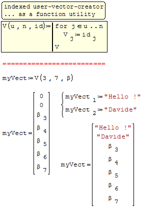

Hi. THis also fails too. Actually, it is a short form for the function NameVec in mathcad.

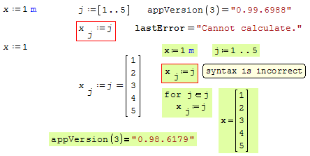

"can not calculate" because "syntax error"
"can not calculate" also appears in 6179 and 5346
resulting from more than a single "syntax error"
There's no indexing in your LHS; the syntax you were looking for is the following:
"can not calculate" also appears in 6179 and 5346 resulting from more than a single "syntax error"
This is because implicit assignment loops by vectors are available since SMath Studio 0.99.6638, in previous versions it's invalid syntax.
Yes Davide, missing for local implicit previous 6638.
It turns red some of Ber7 & Alvaro stuff.
For the essentials, I don't miss local implicit loop.
Oh, yes, thanks. That's correct.
