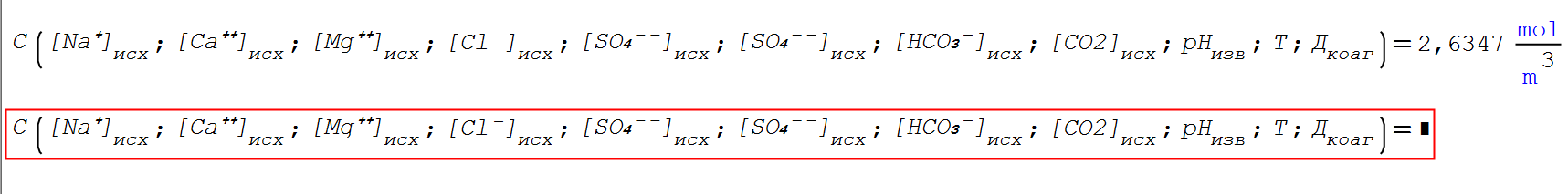

I have corrected but new error message
Predochistka.sm (59,97 КиБ) скачан 1392 раз(а).

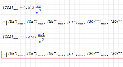

Hi Valery. I guess that it has some minor issues about units and with variable redefinitions inside of the body of procedures.
Predochistka.sm (65,34 КиБ) скачан 1386 раз(а).

I call the function one more and get an error. Why?
Predochistka-Err.sm (62,61 КиБ) скачан 1399 раз(а).

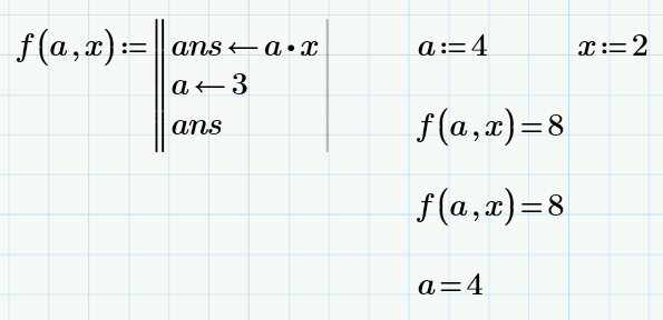

You redefine some function arguments inside the function body. That change its values globally:
See the green area in the document. Also, as an example:
Prime
