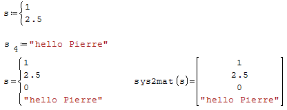

When I try to use the list operations according to the handbook I can't seem to get this to work.
See attaches pictures.
Can you tell me what I'm doing wrong here?Файл не найден.Файл не найден.

There might be 2 common answers:
  1. you aren't using the evaluate operator = or CTRL+. or from the buttons in the Arithmetic toolbox:
  2. you are using the subscript symbol (decimal symbol) instead of the element function available with [ or el( or from the buttons in the Matrices toolbox:
for what I can see from your screenshot, my guess is that you are in the 2nd case

Thank you Davide,
That was indeed the problem.
