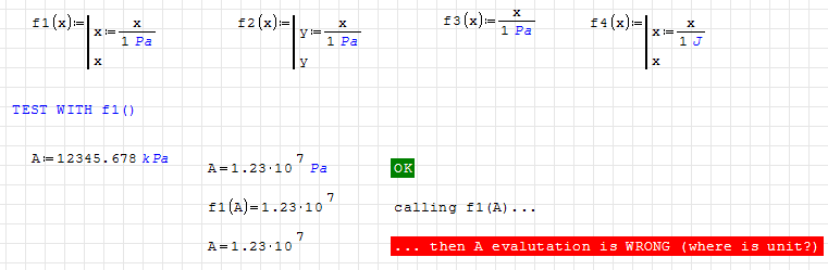

Hi
someone can confirm this issue?
seem that:
- it's not related with optimization
- appears only when you redefine an internal variable inside a line() in a user-function, making them dimensionless
best regards,
w3b5urf3r
#2 Опубликовано: 09.07.2012 06:13:45
Hello w3b5urf3r,
This is related to changing the function arguments. As your function is defined as f1(x) and you actually change x then if you call your function with f1(A) then A will change as well. Your function f4(x) actually changed its argument too.

#3 Опубликовано: 10.07.2012 12:34:34
Hello w3b5urf3r,
Hi Omorr
you're right, f4(x) cause the same issue...
I don't know if it's a bug or a feature, but it's quite strange for me... In my mind I think that
the input variable should not be modified, unless the change it's invoked directly (A:=something)
best regards,
w3b5urf3r

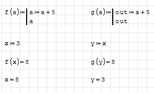

#7 Опубликовано: 23.10.2012 14:19:55
I don't get this
One just should remember that changing value for the variable of the same name as defined in function's arguments for such functions will also override global value of that variable.
I am running into a problem where I have f(x,y):=2x+y When I define x:=? and y:=? I get the correct result. However, WHEN I re-define x and y and reuse the function, the answer is ALL over the place. Can someone give an example explaining what Aundrey ment (see quote)
I think that the image below could be useful to explain the behavior
Using f(a) the input variable - x, will be modified by the function;
Using g(a) the input variable - y, doesn't change.
regards,
w3b5urf3r
