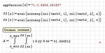

Thank you. But the problem is not because of eval(). She's somewhere deeper. My f3(x) and f4(x) limits are ainterp() of the table data.
Hi avp. Try using eval() for ainterp().
Александр 06.07.2022 03:10:00
#23 Опубликовано: 06.07.2022 03:38:05
Александр
Александр
Thanks, this is how the integrals are calculated, but the function containing the integral inside still returns an error. Accordingly, the final result of the calculations still failed to be obtained.

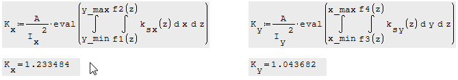

Hi, Alvaro.
The result is not correct. The result should be Kx = 1.233, Ky = 1.044
#29 Опубликовано: 08.07.2022 13:09:49
... those values are same in my document.
You didn't report working/crap ?

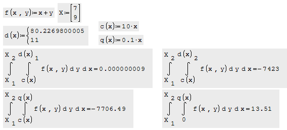

#32 Опубликовано: 10.07.2022 21:10:02
... code that test double integration in your latest SS.
Hoping more Collab will code as well to sanity.
