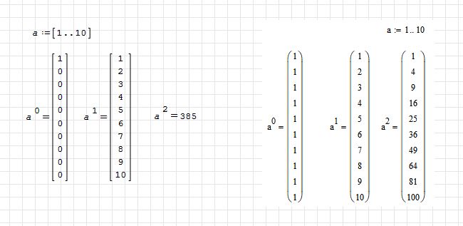

How can I equate power of range to the following? How can we solve this error, anything power should be 1.
When a range is square, the return answer is total of square value.
Page5.sm (9,89 КиБ) скачан 770 раз(а).
#2 Опубликовано: 21.01.2021 16:15:00
As you evaluate over a vector, use the vectorize operator.

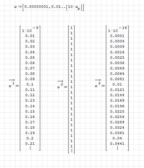

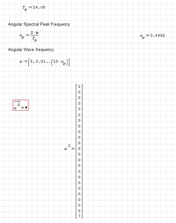

I tried to vectorize the following. What have I done wrong?
Page6.sm (5,22 КиБ) скачан 812 раз(а).
#4 Опубликовано: 21.01.2021 16:40:37
1 080 сообщений из 1 752 понравились пользователям.
Hi. There the problem is 0^0, it is undefined, at least in SMath environment, and probably it's the best choice: return an error if appear. That for the vectorization. About w^0, without vectorization, seems that SMath try to do a scalar product, like in w^2. Remember that a^0 = 1 for a <> 0 it's by definition, not by any theorem.

I am trying to plot and integrate, but no luck
Page4.sm (20,72 КиБ) скачан 775 раз(а).

I just need to put a very small values instead of zero.
