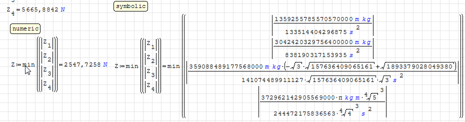

The issue is related to the symbolic optimization. Switch the optimization of the definition to numeric to solve the issue.

![2015-04-16 10_41_19-SMath Studio Desktop - [KP at rafters.sm_].png](/ru-RU/files/Download/Vod8NN/2015-04-16-10_41_19-SMath-Studio-Desktop---[KP-at-rafters.sm_].png)
