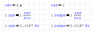

It seems that this issue from 10 years ago has resurfaced (I'm using version 0.99 Build 7822 on 64-bit Windows 10). I'm responding to this long dead thread, since this is clearly the same problem as before, and a Google search didn't find any other similar problems).
SMath (erroneously) produces:
1 rpm = 0.1047 Hz (= 2π/60 Hz)
1 radpm = 0.0167 Hz (= 1/60 Hz)
2π Hz = 60 rpm (= 1 rev/s)
2π rad/s = 6.2832 Hz (= 2π Hz)

But as soon as they're combined with time, SMath manages to mess up the calculation:
1 Hz = 1 rad/s ====> (should be) ====> 2π rad/s
1 rev/min = 1 rpm = 0.1047 Hz ====> (should be) ====> 1 rev/min = 0.0167 Hz
1 rad/min = 1 radpm = 0.0167 Hz = 1/(60 s) = 1/60 s^-1 ====> (should be) ====> (1/60 rad/s OR (1 rad)/(60 s) --- maweilian's proposal about radpm incorrect... what he said should be applied to rpm, NOT radpm).
