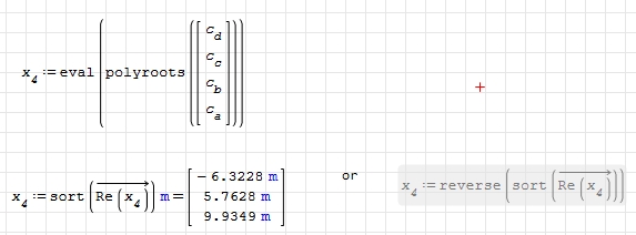

Usually polynomial roots sorting can't be done, just because they are complex numbers in the general case, and you can't define an order relation there. But forcing to get only reals, you can use sort() or reverse(sort()). The same could be done with the solve code at the end of your document.
Alvaro,
Thank you. Did not think about sort(), that would do the trick.
Is it possible to extract solution(s) from the vector that satisfies 0≤x≤L?

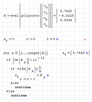

Hi. Sure. For instance can use a for loop, like in the attached.
cubic.sm (82,78 КиБ) скачан 1194 раз(а).
but I didn't quite understand why polyroots() doesn't sort its solutions. Any insight on that matter?
The problem is that the complexes cannot be ordered, so there is no standard about how to present the results.
However, since the roots of a polynomial are usually calculated as the eigenvalues of the companion matrix, and numerical procedures usually order these eigenvalues according to their magnitude, which is a real number, since it does have applications to keep the large eigenvalues and neglect the small ones, perhaps that is the order in which the roots appear in polyroots (): ordered by their complex magnitude, but I can't be sure, since I don't know the SMath routine for its calculation.

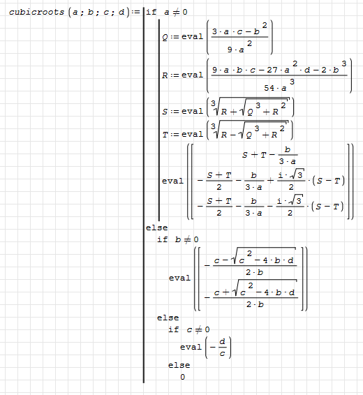

Alvaro,
Thank you for the beatiful way of filtering out the relevant roots. I have some questions.
1. Why do you use length(R) rather than rows(R) to determine the upper limit of the range?
2. Is abs(Im(el(R,k)))<10^{-12} the only way of determining if a number is non-complex ie. has no imaginary part (I dont know the correct term for such a number, or is it Reals?)
3. Would you trust polyroots() over someting like the cubic solver in the attached sheet? I want to use code that finds the solutions symbolically rather than numerically.
4. I should probably define a function that finds the roots of a polynomial that are within a range if I want to to this several times within the same sheet?
Best regards,
cubicroots.sm (9,75 КиБ) скачан 1271 раз(а).

3. Would you trust polyroots() over something like the cubic solver in the attached sheet? I want to use code that finds the solutions symbolically rather than numerically.
3. Your cubic is incorrect vs the conventional attached and Polyroots.
4. That's another story but can be done from scanning trough the various
vectors you want to explore. Possibly plot/stack all explorations.
More and + interesting ... Jean
cubicroots [sanity check].sm (37,78 КиБ) скачан 1081 раз(а).

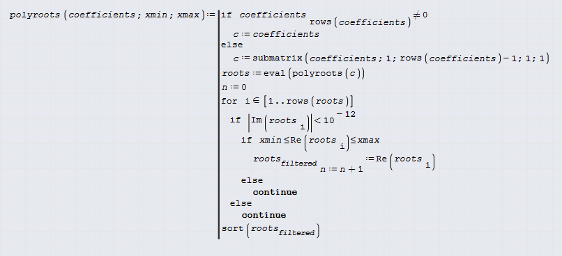

1. True Vectors are column vectors, the expression "row vector" actually means nothing. But ... columns don't look good. Using length() instead rows() I can use row or column vectors in my procedures.
2. No, it isn't. But routines in polyroots() usually introduce some imaginary parts in roots because roundoff errors evaluating the discriminant of the polynomial equation. The question Im(R.k)=0 could look better, but for numerical methods it's impractical.
3. I don't know the internals of SMath polyroots(), but I'm pretty sure that can't handle symbolic values. And I'm pretty sure also that an application in civil engineering with symbolic expressions for cubic polynomials roots requires a very powerful symbolic kernel, and SMath isn't at that stage right now.
4. Sure, first use your cubic, which works well and it's equivalent to polyroots(reverse(stack(a,b,c,d)) and then define another for take only roots in the desired interval. Notice that in my procedure I assign x.4[n:=n+1] to R[k] but it's more correct assign to Re(R[k]).

Thanks for the explanations.
Re 3, I think I worded myself poorly. Numeric evaluation of algebraic equations are fine by me, I just didnt want to code with a numeric tool like solve () that just checks all the values wihtin it's range to find the roots.
I guess there is no reason to use my own code to solve polynomials when SMath has polyroots. The cubic solver from my last post was something I made before I discovered polyroots.
Re 4, does this look like what you would have made to serve this purpose?
Best regards,
