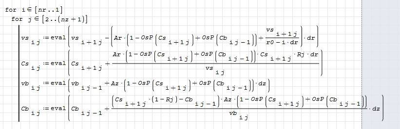

When I interrupt the calculation, it stopped at 2nd for loop, i=50 and j=9. Some of the variables has expression, for example, vs(i,j), some of the value was the initial value of -1, but calculated values has units that wasn't canceled. vs is supposed to be dimensionless.
Any trick to solve this?

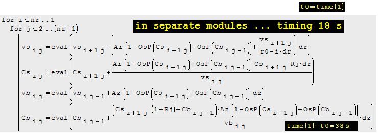

WroteHi. Two issues. First, you use two percent symbols, but forgot to put them as units: try to add them as '%, and they goes in blue color.
For the second, your observation now it's correct:WroteI suspect the variables stored the expression instead of results, which could take too much memory?
and can speed up a little the calculation using eval for each line:
Thanks a lot. It appears, eval is a very important function. I tried to eval every dimensionless variables and functions, such as OsP, dr before the loop. And it took some time finished the calculation. Still, takes ages long comparing to mathcad.
I hope the developer can improve this part soon. After all, the calculation load in my program is not heavy. I am really afraid if I introduce some iterations.
Thanks again

WroteStill, takes ages long comparing to Mathcad.
Mathcad is a semi-compiled CAS.
In separate mode my 1.66 GHz Win 7 calculates the 4 matrices in 18 seconds.

Leave them in separate modules, then collapse, it might reduce timing by ½.

1. Separate modules in the attached... Two complain, but produce.
2. Try matrix operator matrix(3,4) to see if it can help you wrt the project.
3. I know no other way to construct your 4 matrices.
4. From the matrices, your can select any col/row
... you can sub-range any part ... you can unwrap in single vector.
Cheers ... Jean.
