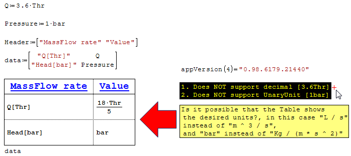

Will it be possible?
Table_Units.sm (9 КиБ) скачан 103 раз(а).
Carlos
#2 Опубликовано: 07.03.2018 14:41:34
1222 сообщений из 2150 понравились пользователям.
Tne solution isn't smart at all but it is possible. Would be half the trouble, if one could store and use the unit in the unit summary vector "us" as they are defined (prevent symbolic processing, which even can't be suppressed when setting optimization to none).
Table_Units_Kr.sm (11 КиБ) скачан 88 раз(а).
CBG 07.03.2018 15:11:00
#3 Опубликовано: 07.03.2018 15:11:23
CBG
CBG
77 сообщений из 312 понравились пользователям.
Thank you very much Martin,
But now how do I include the header?
since it does not appear as an option in the heading list.

The header can only be specified for the columns of the data matrix, thus only single column objects are listed as choices for header variable. I don't know of options to fill the fields above the left and right row titles.

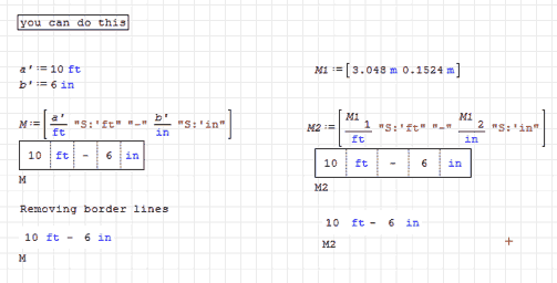

on the topic of units within the table, would the following be possible:
a:= ft
b:= in
matrix:=[a "-" b]
table:= matrix
Show a and b in a table with their corresponding units (ft and inches respectively)
Right now, a and b are shown as default unit only. Both are the same unit.
Why you may ask? This is an attempt at showing mixed units as a single output result in sheet. Often lengths are specified in feet + fractional inches.
#9 Опубликовано: 18.06.2018 22:30:22
CBG
CBG
Something like this?
Table_Matrix.sm (8 КиБ) скачан 91 раз(а).
Best Regrads
Carlos

CBG, The idea is to show mixed units as single linear output.
Mixed Units Ideas - Table.sm (25 КиБ) скачан 75 раз(а).
#12 Опубликовано: 19.06.2018 13:39:04
CBG
CBG
Mixed Units Ideas - Table_R1.sm (38 КиБ) скачан 74 раз(а).
Carlos

Hello ElSid
1).-The "S: '" is to be displayed as a unit in blue, and I learned it from Martin Kraska.
3).-It is the table region, which calls the variable matrix with the name.
Carlos

#17 Опубликовано: 27.06.2018 14:31:56
Wesly Centerwall
Wesly Centerwall
26 сообщений из 156 понравились пользователям.
Jean,
"S:'L/s" should be "S:'L/'s". Note the added "'" in order to show "s" as blue unit.
#18 Опубликовано: 27.06.2018 19:47:27
Jean,
Thanks for that one wb.c ... corrected !
