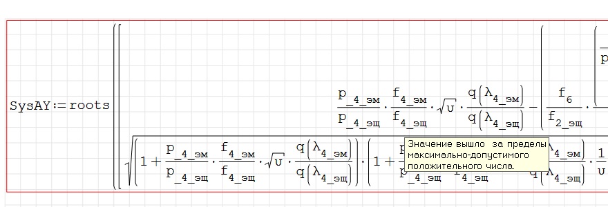

Who has faced such a problem, how can it be solved?
Project from below

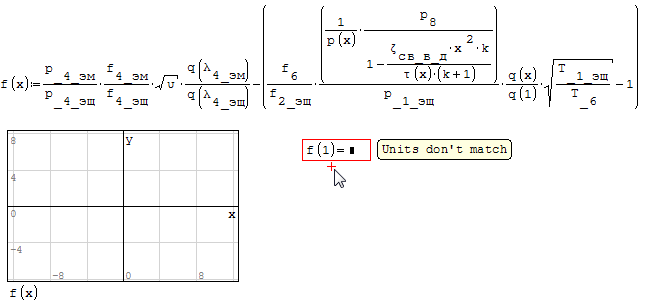

WroteWho has faced such a problem, how can it be solved?
"result above max ..." has no pertinent meaning in your project.
If you attempt "roots" on the numerator only ... "Units don't match"
No need to go further ... zap the units in the project.

I made a mistake, there should be a solve function, in this place the same error

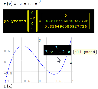

Common from ill posed construction.
Consider yellow up until you can plot that system(x,y):= ....
from there it should be solvable.
Poverochnyjj raschjot ehzhektora [zap Units, define the Undefined ...].sm (94 КиБ) скачан 78 раз(а).

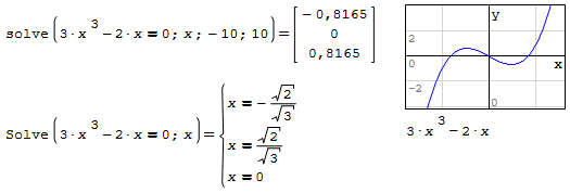

Go on dreaming. If you are in non-linear systems and you can't find a symbolic solution (Maxima's Solve() got stuck when I tried) then you need numerical procedures for solution. These always need an initial guess (Newton-Raphson) or a search region (bisection). The various procedures just differ in how efficient or how robust they are. Some of them may have quite impressive radii of convergence for particular systems but none has infinite radius for all systems.
Furthermore, there remains the problem of uniqueness of a solution. The only solvers in SMath capable of providing multiple solutions are the
- solve() finds all solutions of a single equation within a given range
- Solve() from the Maxima plugin, which finds symbolic solutions.
Blatt21.sm (5 КиБ) скачан 76 раз(а).

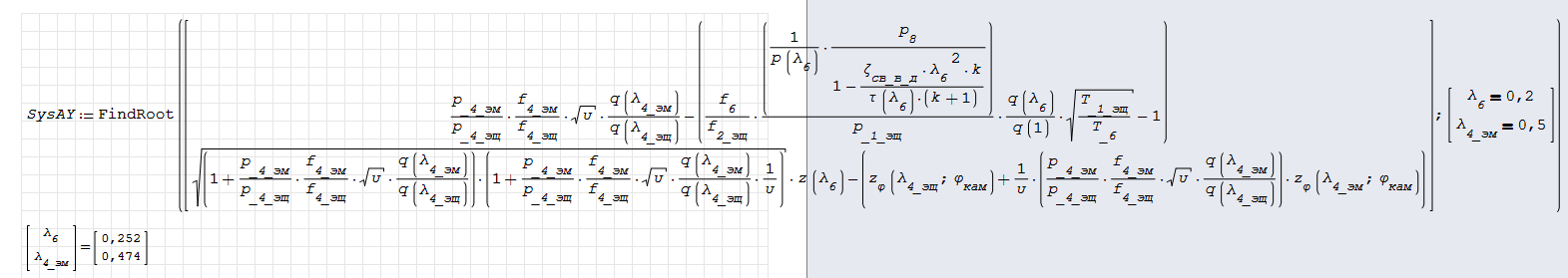

What linear interpolation is doing here ?
If that document makes sense, return with comments.
Poverochnyjj raschjot ehzhektora [solve].sm (95 КиБ) скачан 75 раз(а).

I imagine you mean the very last part of the document.
The system looks ill posed, visit Solve Lecture last 3 days.
Poverochnyjj raschjot ehzhektora [solve, spline].sm (104 КиБ) скачан 78 раз(а).
#17 Опубликовано: 17.02.2020 09:35:01
... maybe we can leave it as such ... cleanup ?
Poverochnyjj raschjot ehzhektora [solve, spline].sm (110 КиБ) скачан 80 раз(а).
