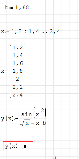

Hello everyone, I have such a task here, you need to find y (x) for each value of x in the range from 1.2 to 2.4 with a step of 0.2.
X I managed to display and see the result. However, when writing the formula y(x) and trying to display y(x), it gives an error. help me please
Plus I can't figure out how to write sin^2(x) in order to have a formula...

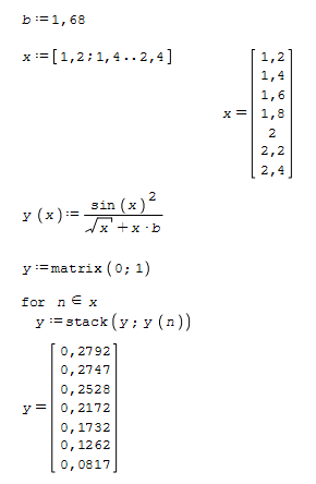

Seems to be a very old version of SMath Studio (display of ranges, round matrix brackets). May well be that the vectorize function isn't available yet in that version. You might consider upgrading or you have to use an explicit loop with for or while.

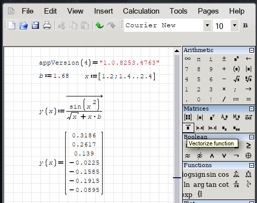

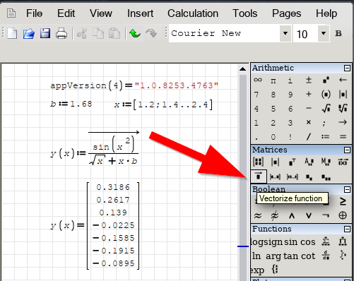

Let's visualize what Martin has perfectly described.

Ok, I tried to do it through the "for" loop, but it didn't work out very well for me, can you tell me how to do it?

you can either click Vectorize button at right tool window, or directly write vectorize as it is a function.
You can see the button in picture I have uploaded at post #6.

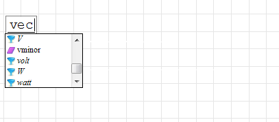

by clicking on vectorize I have the followingizobrazhenie_2022-09-27_112045189.png
#11 Опубликовано: 27.09.2022 05:35:46

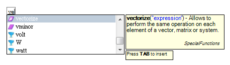

That's the dinamic assistance when you write directly vectorize
Here is the vectorize button as shown by overlord in post #6
As stated by mkraska, it is possible that you are using an old version of the program that doesn't have that function (in that case you have to use a loop to evaluate the function for each n-th value of x)

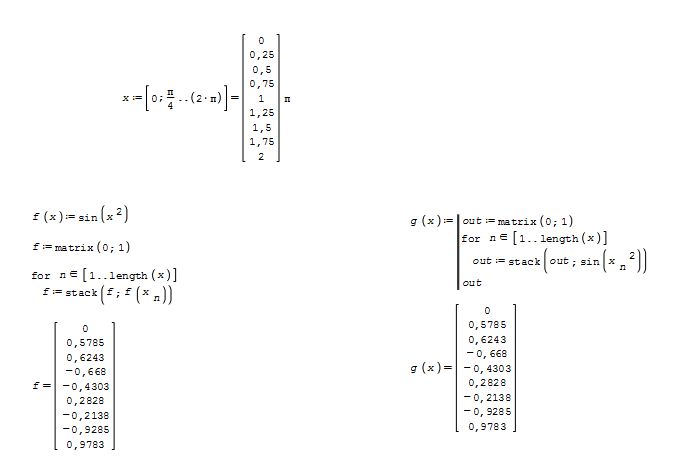

Therefore you are in this case:
As stated by mkraska, it is possible that you might using an old version of the program that doesn't have that function (in that case you have to use a loop to evaluate the function for each n-th value of x)
You have to update to a new version if you want to take advantage of vectorize, otherwise you have to use a loop from the programming palette (for or while); here you have a couple of ways
loops.sm (7,37 КиБ) скачан 1137 раз(а).
BTW vectorize() is available in stable releases since SS 0.98.5935 (April 2016); square brackets in ranges are more recent, since SS 0.98.6593 (January 2018)

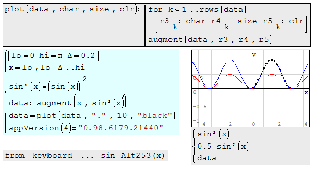

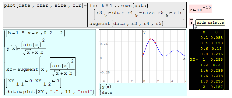

sin²(x) is silent code for purpose, often replied by maple
You have to code it as exemplified.
Cheers ... Jean.
Maths sin2(x) plot.sm (6,47 КиБ) скачан 1170 раз(а).
