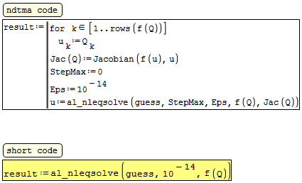

Fragments withal_nleqsolve() can be reduced to one line.
alnlegsolve(3).sm (635,89 КиБ) скачан 1382 раз(а).
WroteHello,ndtma
Fragments withal_nleqsolve()can be reduced to one line.
Hello Ber7,
Thank you very much for your very valuable suggestion.
It works fine.
Thank you for this excellent example.

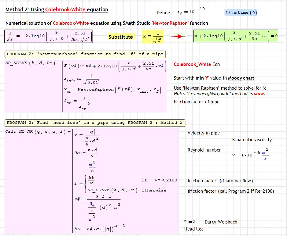

In my original post #1, the K values were simply computed using a given formula,
and head loss in each pipe computed accordingly.
In Method 1 of the attached example, friction factors (f) depend on the Reynold numbers (Re)
of each pipe and computed using a given formula involving Re.
In Method 2, NewtonRapson function of SMath is used for the numerical solution of the
implicit Colebrook-White equation to find f.
Many thanks to Ber7, Alvaro and Carlos for your earlier suggestions on the subject.

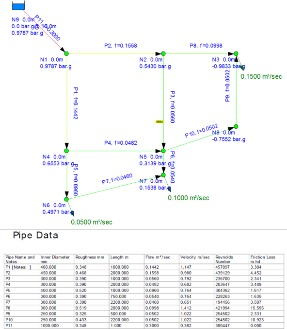

WroteHello ndtmda
Here are the results of your example calculated
with a very old version of Pipe Flow Expert.
Thank you Carlos!

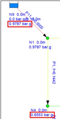

WroteHello Carlos
Can you please explain how the marked values of gauge pressures are calculated?
Thank you.
This pressure (0.9787 bar g) is caused by the water level in the tank, which is 10 meters.
The pressure of 0.6553 bar g is obtained by subtracting from the inlet pressure
of 0.9787 bar g. the losses in the pipe of 0.3234 bar g (3.304 m hd)
The system is not correctly resolved for the pressures, since nodes 3 and 8 have
pressures below atmospheric.
Carlos

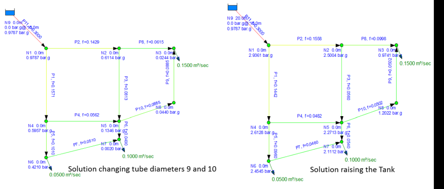

You're welcome.
Changing the diameter of tubes 9 and 10 from 0.25 m diameter to 0.5 m, the problem of negative pressures is solved.
Another way to solve it is by increasing the level below the tank from 0m to 20m. and with the liquid level at 10 m

Hello Carlos,
Can you please post the Pipe Data Table (with Pipe Number, Inner diameter, ..... Re, Friction Head loss)
for the case Changing the diameter of tubes 9 and 10 from 0.25 m diameter to 0.5 m..
as I get different results for this case.
Hope I am not troubling you.

There is no problem.
Here is the requested table
Carlos
