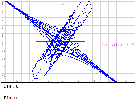

#20 Опубликовано: 02.08.2016 15:22:02
Thanks Ber7 for your repost/new animations. Some don't work in Smath 5346,
so what. Animation is a very nice feature from Smath.
Rotate XY.sm (474 КиБ) скачан 1563 раз(а).
