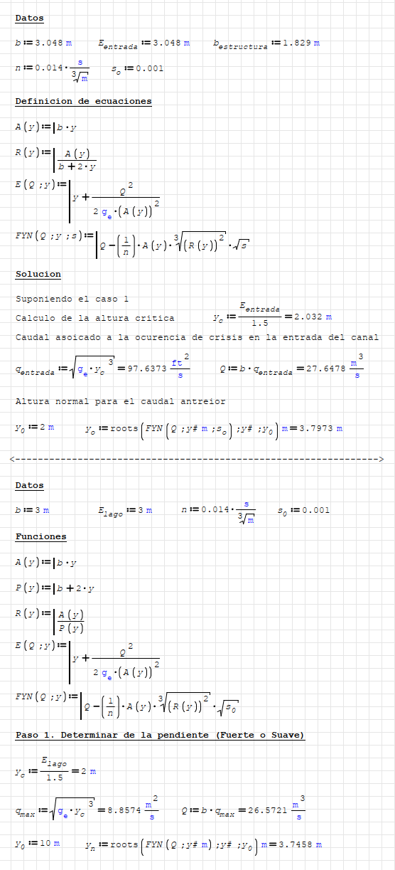

But the programming is the same in Smath? I mean, for example the FYN or root function still works?
#7 Опубликовано: 20.12.2021 16:08:32
Not same, but very similar.
calculo.sm (22,39 КиБ) скачан 1166 раз(а).
Вячеслав Мезенцев 20.12.2021 16:16:00, Lelar 20.12.2021 22:31:00
#8 Опубликовано: 21.12.2021 12:05:20
But the programming is the same in Smath ?
I mean, for example the FYN or root function still works ?
Smath has many solvers. FYN from implicit roots(,,,).
roots will solve on the canvas [MACH number]
calculo Direct Code.sm (20,59 КиБ) скачан 1112 раз(а).

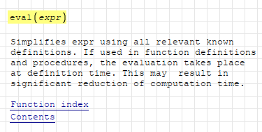

Two typos in your 'chito' document: Manilla, Kota Kinabalu in Sabah.
You are right, no need to Dy:=eval(,) is so fast.
eval(,) applies to parse result as a numeric entity.
It breaks the chain calculation. Per application experimental.
The rule eval(,) is crucifying ... watch the demo attached.
from 65 s down to 0.015 s !!!
Take care ... Jean
Maths eval(,) TEST.sm (19,27 КиБ) скачан 1091 раз(а).
