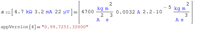

Units are not simplified (i.e. to ohms etc) from the base SI units, when they are in matrices.
This means that I can't really use a vector to return tuples from a function or display numbers with mixed units, as the units become unrecognisable.

That's a very twisted solution!
Here's the catch: I want to return a tuple of two values where I don't know what the units will be.
I thought num2str() might be able to help me just return printable strings, but it also returns the expanded base units.
num2str(2.3ohm)="{23*'kg*'m^2}/{10*'A^2*'s^3}"

Wrote...
Hi. If you want the string with the value and the unit, try this: with this post ( https://en.smath.com/forum/yaf_postst17763_Dimensions-utility.aspx ) you can seek the dimensions of an unit, further, you can add a column in the 'Dimensions matrix with the unit as string for each one dimension and return it in some function UnitString, instead the dimension name.
Or can use this if don't want to work with strings:
