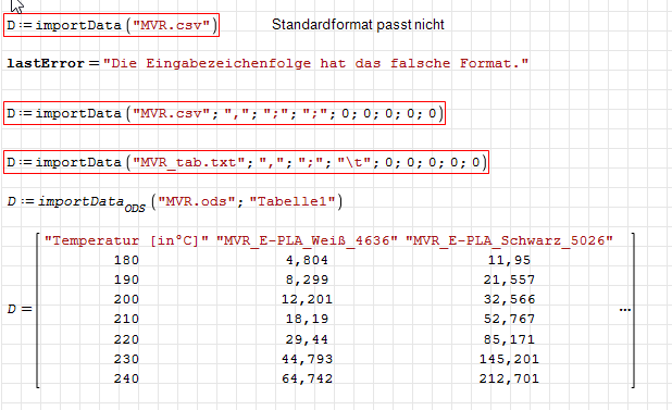

Hi, I experience problems with import of text files. ODS and Excel work.
In the attachment you find the worksheet and the data in various formats.
Import.zip (170,68 КиБ) скачан 149 раз(а).

Are these similar bugs? I reported one about 5 years ago.
https://smath.com/en-US/forum/topic/kWoP42/importData__#msg127602
