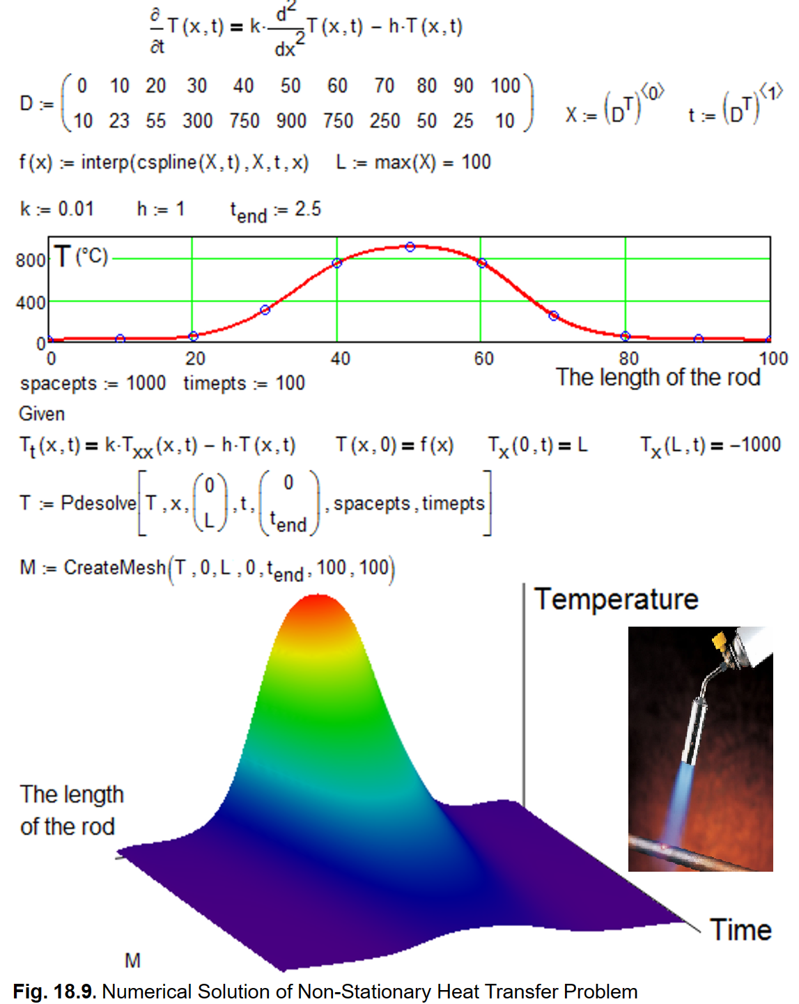

We heated the rod in the flame of a burner.
How will it cool down?
Non-stationary mode!

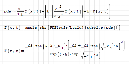

Hi.
Valery Ochkov 05.07.2023 23:01:00
#3 Опубликовано: 05.07.2023 23:02:44
Valery Ochkov
Valery Ochkov
66 сообщений из 690 понравились пользователям.
Hi.
Thanks!
And what about the ICs?
We must use one numeric not symbolic method!

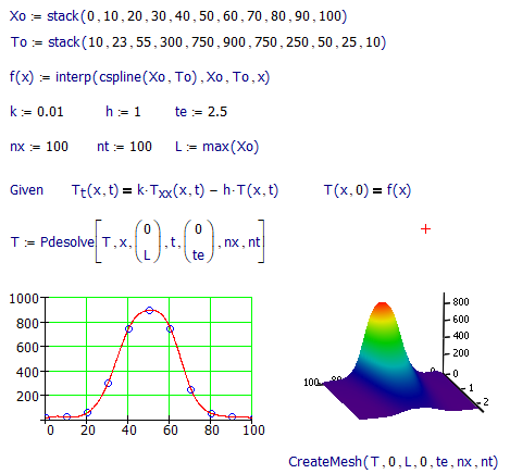

For your data set D ... 3 options:
1. Smath ainterp, cinterp ...integrate/solve(4)/zap derivative.
2. Mathcad l_p_c implemented Smath [1rst derivative, integration]
3. Thiele Smath ... symbolic derivative, integration.
If you have interest in methods [2,3] I will attach.
Since nearly ~ two weeks, Smath Studio can't be downloaded.
Replaced by Smath Solver ... a damned crippled version.
Cheers ... Jean.
Cheers ... Jean.
Thanks!
I would like as here
https://en.smath.com/forum/yaf_postst23506_Cannot-plot-T-x--y.aspx
#6 Опубликовано: 06.07.2023 09:53:10
Thanks!
Thiele_0 Model QUICK.sm (24,5 КиБ) скачан 1216 раз(а).
Maths EDU [l_p_c_splines TOOLBOX] Copy.sm (584,29 КиБ) скачан 1102 раз(а).
These two documents are SS 6179.
Please, confirm you can open.

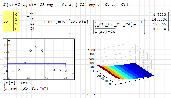

Using maple, you can try to use a maple "component" or a maple plot, which gives more flexible access to maple structured functions.
Also, there are some numerical procedures for pde's in Maxima.
Notice that in Mathcad the border conditions for δT(x,t)/δx are not considered for obtain the solution.
With SMath, you can try to adjust the curve choosing good guess values in the yellow vector.
pdesol_num.sm (14,78 КиБ) скачан 1194 раз(а).
