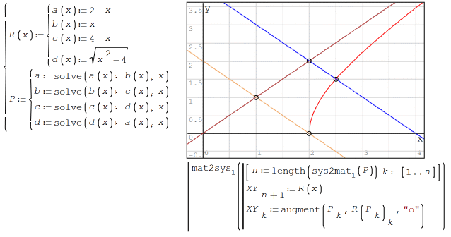

Hi. In the attached, can plot points and functions, but not both in the same plot.
Double Integral.sm (10,7 КиБ) скачан 1251 раз(а).

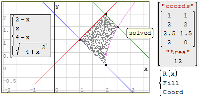

The old style works otherwise.
You can fill the region of integration.
Double Integral.sm (16,39 КиБ) скачан 1242 раз(а).
Double Integral FillRegion.sm (17,83 КиБ) скачан 1208 раз(а).

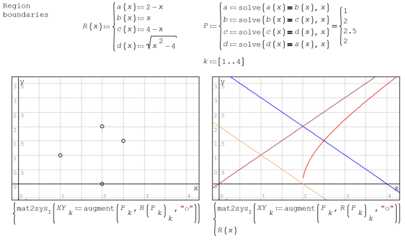

The behaviour of arguments in nested lists seems to be unpredictable, at least I don't see the rule.
Thus, re-arranging objects works but I don't know why.
Double%20Integral_Kr.sm (11,48 КиБ) скачан 1423 раз(а).

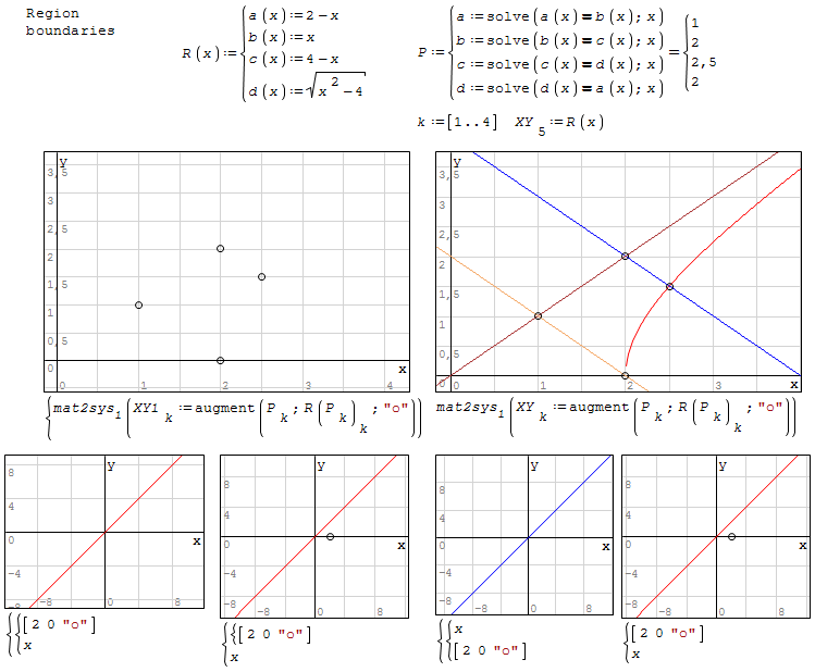

Hi Martin. Thanks for the tip. I guess that I take this form, from you suggestion:
#5 Опубликовано: 17.11.2018 18:18:39
... personally: I prefer the more conventional form.
The example in view may fail in other instance(s).
3 in one: functions, solutions, fill-in region.
X_Y Plot wisely [Solve] Boundary.sm (39,51 КиБ) скачан 1084 раз(а).
