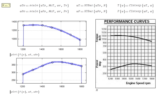

#1 Опубликовано: 08.06.2021 18:11:10
From the textbooks to a SMath evaluable function
Digital Image Function Analysis.sm (538,87 КиБ) скачан 1349 раз(а).
Digital Image Function Analysis.pdf (1,56 МиБ) скачан 1020 раз(а).
Image for the analysis:

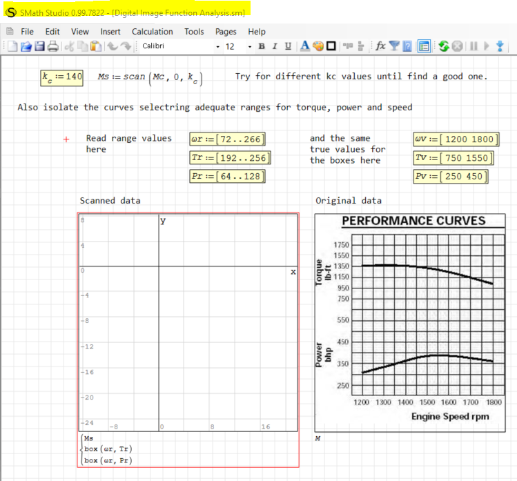

Hi overlord. Thanks. Do you download the image "imgPerformance.jpg" and put it in the same directory than the sm file? It is the only issue specific for linux that I can see. I know, it is showed instead given the link for download. Here it is as zip file:

Yes, I have downloaded the image already.
It starts to give error on Ms:scan(Mc,k1,255)
`Argument doesn't meet to expected kind`.
Perhaps the image2rgb doesn't work under linux.
M matrix is filled with zeros, nothing else.
#5 Опубликовано: 09.06.2021 14:47:49
Hi. I remember now that the worksheet also use Mean, from statics plugin, and I put it definition at left margin, but disable. Maybe it's that one. This version have embed image matrix, and except for the XYPlot, I guess that it have not any other plugin.
Digital Image Function Analysis - Image embeded.sm (4,02 МиБ) скачан 1312 раз(а).
#6 Опубликовано: 09.06.2021 15:40:59
I have statistical plugins with linux.
In windows, with same plugins and setting it solve.
And matrix is not full of zeros.
image2rgb is not working under linux.

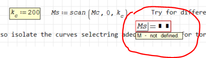

First, why the error in the SM file? I just downloaded and opened using Portable version on both Windows 10 and Linux.
#9 Опубликовано: 14.06.2021 13:10:49
Hi. You can try to eval only Ms outside the plot for read the error, if it is not an specific error related with the plot.
#10 Опубликовано: 14.06.2021 16:15:44
Ruben Sidranski
Ruben Sidranski
Ms is not defined. As you can see, I changed kc as well.

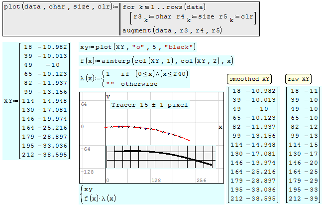

#14 Опубликовано: 16.06.2021 08:15:51
Elsid,
My offer via Paint is valid, but delicate from too thick graph.
My other tool is via Tracer 15 [freeware]
Paste image as is in Tracer, capture at will pixels.
Each capture is stacked in vector, obviously noisy.
Once in hand, Ksmooth the Y vector ...
We have Ksmooth as a Smath utilities.
Once smoothed, spline ... Job done.
Have a good day ... Jean

#18 Опубликовано: 23.06.2021 12:21:39
... once pixels in hand ► Ksmooth ► final fit.
