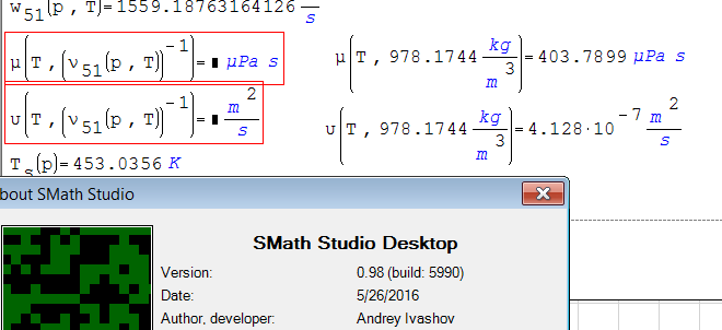

By the way, in SM build 5990 the viscosity calculations under Временные расчёты will throw an error(Units don't match) although units are correct (put them manually and the result is Ok). This error is not present in the previous SM build.
Mike Kaganski 28.05.2016 06:00:00

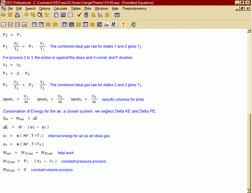

Yes, I say thanks last week in the post of CoolProps. It's a big effort, and they share they knowdalge and expertise, which is very preciate.

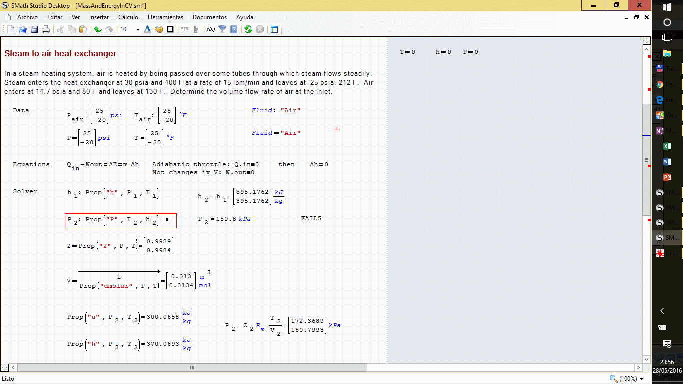

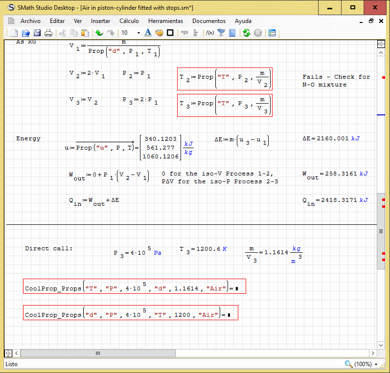

About the fail, which fail is air. And isn't a bug in CoolProps or the wrapper, it's a failure of the model in general: can't derive a dependence between Cp and T, P at the same time. For this reason, which is used is a more simple model for the Cp with a dependence only for the temperature. So, there are no need for poste any issue with CoolProp, because there are not one. Eventually, ask for a new utility: provide ideal gas equations too.
Attached, a capture screen from EES showing u evaluated only as funcion of T.

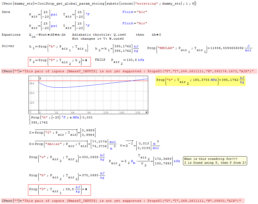

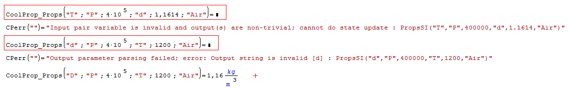

Actually, I couldn't see this in the sheet you've attached earlier: there seem to be a number of problems in the Air section, including using T[1 and P[1 (extracting elements) where T and P are set to be scalar, and it seems T.air and P.air should be used.
Could you please clean up, refine and annotate your example so that your point would be clear, so that I could try to come up with a workaround? Just out of curiosity.
EDIT: If my presumptions are right, then there's no fundamental model shortage in your Air sample, only not-yet-implemented input pair:
MassAndEnergyInCV-air.sm (25,58 КиБ) скачан 1423 раз(а).
What is wrong here is trying to use two different models in one solution. You use more precise real-gas model for some system properties, and at the same time want to use simpler ideal-gas model for other properties of the same process. This approach is fundamentally wrong, and cannot give you sensible results.
But now I don't understand this:
Sure. Are for teach only, CoolProp can be used, with the same precautions of RefProp for real world problems. Check the las exercise, taken from Cengel (and EES software): CoolProp (and others) fails, and need to downgrade to some more simple model.
This was the response to me informing you that there is an implementation of EOS you shared in the first message. You implemented not a simpler model, so I cannot see an interconnection between my message and your objection. Yes, CoolProp cannot be used for any possible task in life, and it prepares poor coffee, too, but it is suitable for the task that you implemented in the first place.
Could you please clean up, refine and annotate your example so that your point would be clear, so that I could try to come with a workaround? Just out of curiosity.

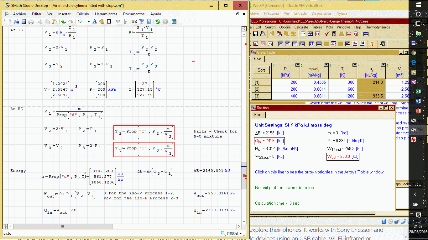

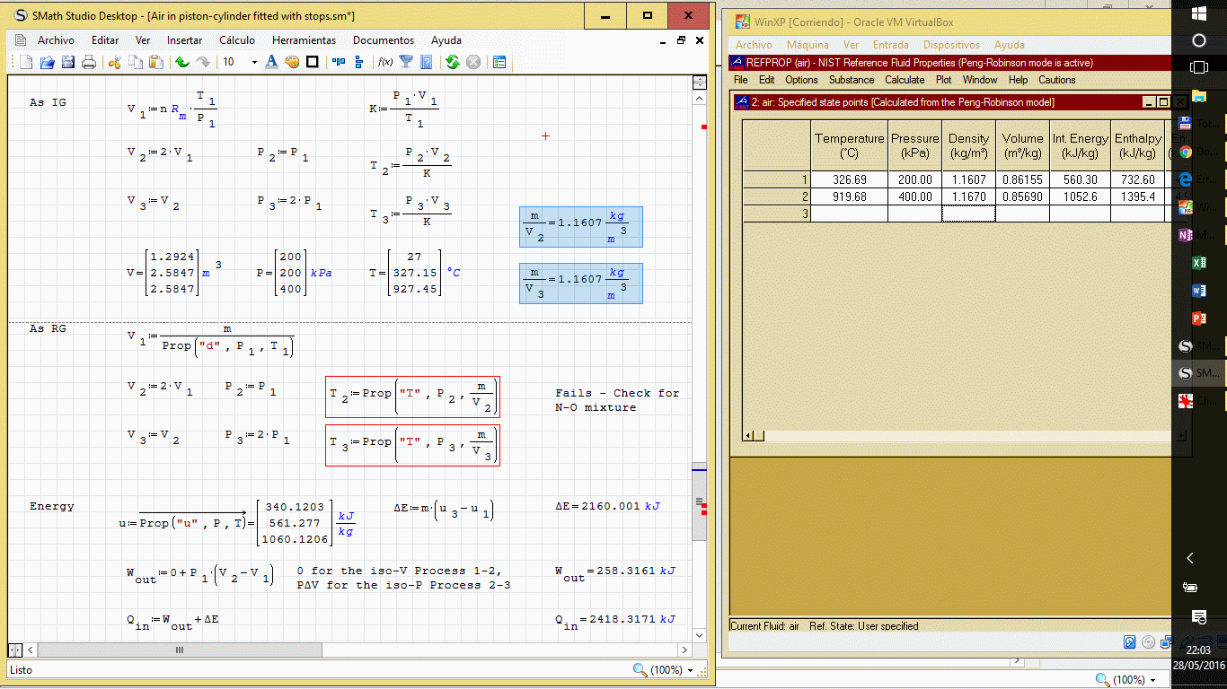

T, P are vectors. CoolProp can't work in that region for air, but isn't alone, there are others (like EES, for example).
Refprop can handle this problem, but with Cp(T) (or Cv for u) I guess.
Attached the workaround: use IG equations (Constant K = P1 V1 / T1 = P2 V2 / T2 ) which give very close solutions.
So, attached, the "clean" implementation.
Air in piston-cylinder fitted with stops.sm (34,65 КиБ) скачан 1412 раз(а).

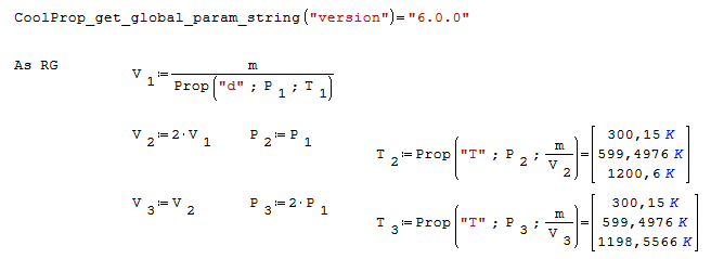

Well, this is already fixed in CoolProp version 6.0.0, but the wrapper isn't yet updated, because in 6.0.0, they broke their get_parameter_information_string.
So, there WAS something to submit to them as an issue.

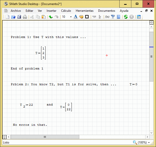

So ... T, P are vectors. T.air, P.air too. Assign's at the left margin like T=0, h=0 as null scalars are usual practice in math cad programs for ensure that redefinitions, like T[2 = xx, don't carry up old values.

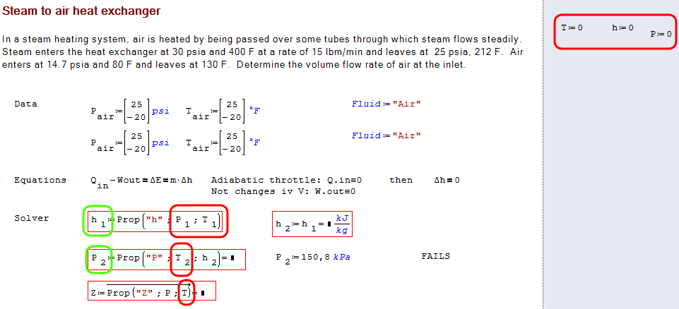

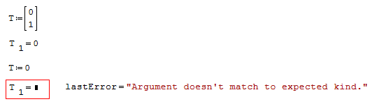

No.
When you assign T:=0, in SMath you actually do set T to be scalar 0.
If you then try to use el() on it, like in t:=el(T,1), then you will get an error that argument is not proper.

You used it in assignment, while I explicitly noted that it gives error when used to get value of an element.
Please re-examine again your file, before further doubting my words.
You assigned P and T to be 0, didn't fill them to be vectors again, and used their non-existing elements in Prop() functions. That gave errors.
If you would assign them values like you shown in your previous post, then it would be a different story.

Red are places where "elements" of scalars were used (last red is where T is still simply 0, no element, but surely not what was intended).
Greens are where you try to "convert" them to matrices.
