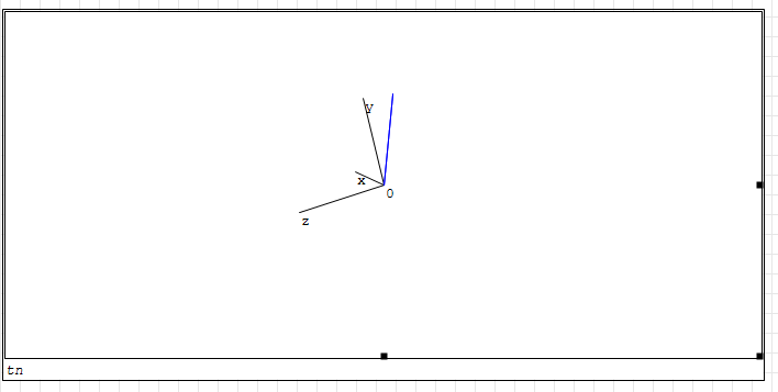

simple stuff like this
results in a weird 3d graph, unless manually refreshed.
I also have to press refresh every time I change anything on the sheet because it goes back to being weird.

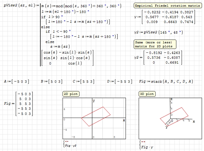

To prevent the 3D graph from changing its perspective, we multiply its matrix by the empirical gamma coefficient.
3d.sm (6,19 КиБ) скачан 1386 раз(а).
what does that even mean? I figured out that the matrix should contain coordinates of the points in its rows, but what's the "empirical gamma coefficient"?
#4 Опубликовано: 05.07.2021 20:36:38
... while remembering Fig*γ is not commutative.

Fridel gave you the minimalist guidance/model 3 cols + rotation.
The 3D plot has a fixed native orientation,
then rotate manually to better view, then capture as fixed image.

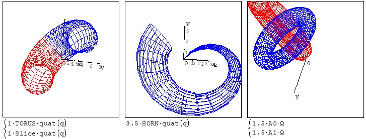

1. open 3D, assign plot argument
2. show/hide axes/grid
3. 3.5*HORN*quat(q)...3.5 zoom at will
4. quat(q) the Quaternion rotation system
5. 'q' 1/24 pre-rotation [Quaternion]
5. mesh CreateMesh either/both directions
6. rotate the 3D manually
