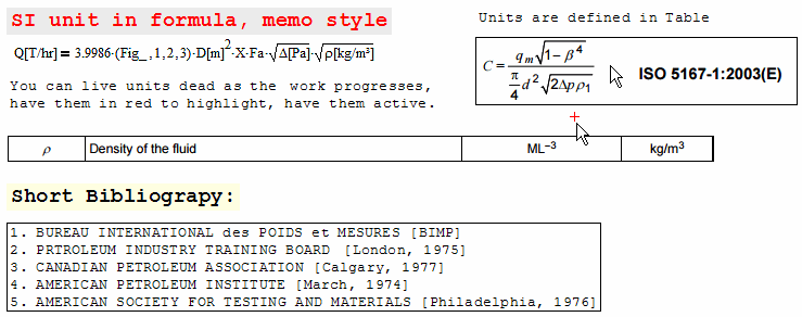

Just for giggles I will do my next calcbook unitless and will see what sort of feedback I will get. ... Assume a spherical cow in a vacuum... Wait! its a coccus with horns and a tail!!!
Jean, you concept of unitless math is very true; however, math applied usually asks for a some sort of a frame of reference, which is given to us by the units.

Alex, what's good about units: they are democratic. Very useful up to college level.
m*m*m*m = m^3 and similar stuff. Entering avdvanced maths, symbolic engines reply
in red [Mathcad 11] or a full page in blue [Mathematica 4.0].
Try this: push the greasy round cow in the square hole ... corned beef for Easternes.

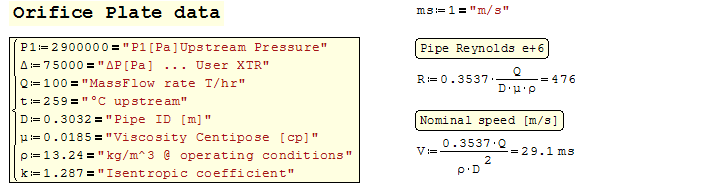

By the way, your Reynolds formula, being physically incorrect, also doesn't compensate for using centipoises.

0.3537 is like a universal constant in the SI t/hr in Process control fluid mechanics.
The all matter is if unit system is proftable use it and abuse reading as you wish.
Don't fill air plane in lbs instead of kg as it happened [miracle, nobody got killed].
Just make your client happy unit/unitless. Wise to know both routes.
Don't forget that most decision makers are old timers like myself, using references
[books, standards ...] that use unitless maths. All your blue stuff would make many
laugh, wondering about the burden to cross check results.
